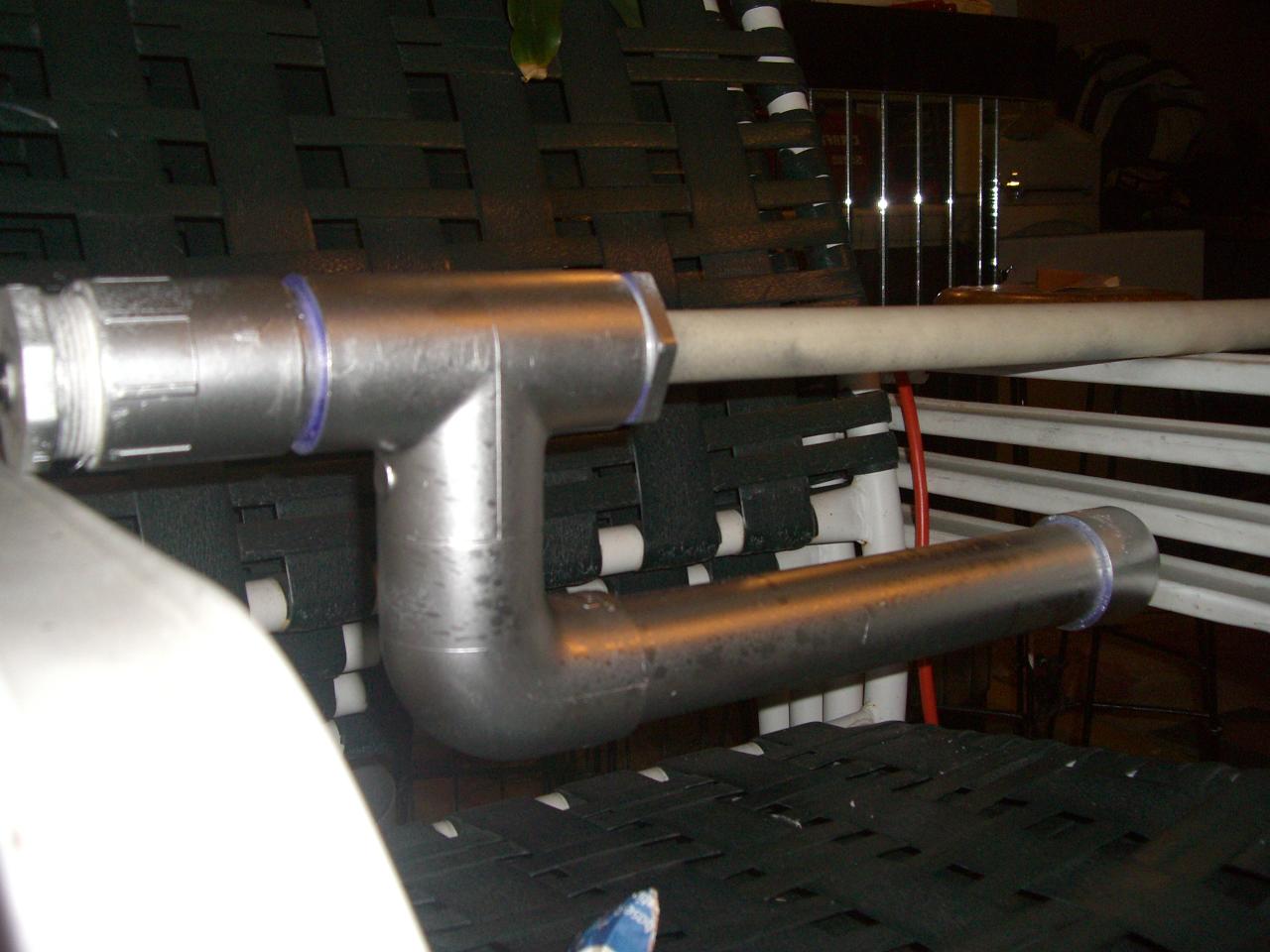

This is My first pistion gun
, i would like to thank MrCrowley for his help on my piston. Its housed in a 1.5 inch tee the barrel is 3/4 nsf-61 Chamber is also 1.5 inch. I just finished today costed me about 30 bucks US. Pistion is made of an aluminum hair formula bottle very light weight its filled with foam and hot glue so theres less pilot volume, its exhausted by a 1 inch sprinkler valve, the bumper is a soft thing from drum symbols
enought talk heres some pictures, no damge shots yet cuase its going to rain for 3 days
, but ill shoot some indoor shots
Guys i finaly got my paint job wanted to try some new color not many people use you guys like?

looks nice, i cant wait for a paint job, the piston looks really nice too.

isn't a 1" sprinkler a little overkill to pilot a 1.5" piston? I don't really care too much but if you just had one laying around I would have used it too. Bet it pilots fast. Plus you get the feeling of pulling a trigger (AKA blowgun) like a real gun

Yeah it kind of is, but he's got the pilot volume to waste and its only going to do good.

it sucks only goes 40 feet ha jk its goes preety darn fast . i did like 3 test shots at with tangerines it it dam loud and it pierced 1/4 inch of wood at 20 psi low pressure cuase dont wana mess up the curing of the glue.
And yea its kinda an over kill but i have big pilot volume so its all good
doesnt look like it needs a barrel support does it?

You probaly didnt need a piston valve for that you could of just used the sprinkler but what bad could a very well done valve like that do to it.

more flow then a sprinkler valve and MrCrowley its been 15 hours already thats why i only did 20 psi wont hurt
