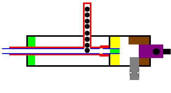

It says it all but it is a question has anybody made somthing like this?
wel I know of the qevs with a pop off but what about a co axial with a pop of?
EDIT: This what it would look like with a modified blow forward brech the whole barrel would move adding a cool effect nice!

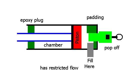

It is a co axial.
It is a co axial.
This is the updated version number two

Hmm, looks legit, but I'd go with and over under piston in a T so you can actually have more than one shot, eh?

you could get more than 1 shot in this and I just did somthing up on ms paint

Well, it may look simple to build a coacial loading like that but in 2D paint drawing its way easyer than in 3D reality.
Do mind that you will have to get the ammo pipe through the wall of the larger bore chamber pipe. Wich would only be accomplised well with a T on the chamber.

It would work if you balance your flows, it's exactly the same principle as this one.
Instead of moving the whole barrel, why not incorporate a bolt into the piston, as had been proposed here?

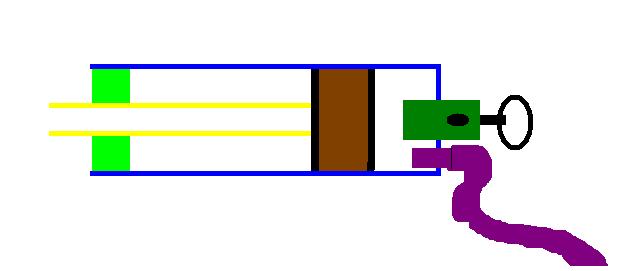

The problem I find is that the air resetting the piston causes just enough blow-by past the piston that enough hisses out the barrel and actually weakly pushes the ammo out.
You see that if you load a piston gun and then try to pump it up. The piston tends to not seal quickly enough.

Not if you have a tight fitting piston :wink:

...or a high pressured air source.
If all of that is worked out, then you can end up with something like this.

I made a EDIT. /\

/\I made a updated look up /\ that version would have a sealing face that seals the pop off when the piston is piloted this alows the pop off to close so that the piston can move forward.
