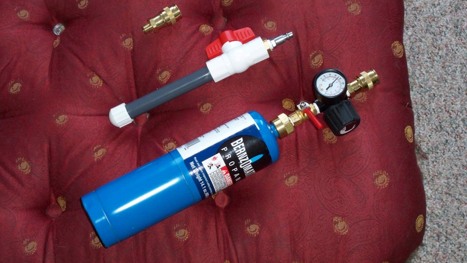

You won't need sched 80 for just a 1x standard combustion unless you just want to spend the extra $$ and if you really really just want sch 80. Sched 40 would be fine for this. You can get a 4' stick at McMaster for $98, part number 49035K33.
Also as I've mentioned before, consider going to metered propane to fuel this baby. Here's a picture of the suggested metering system. Tap a 1/4" NPT hole through 2 layer of PVC (through a coupler and chamber) and install the quick-connect. To use, charge the "hypo" from the propane tank, then take the hypo to your gun, snap in, open the valve to inject your fuel load, close valve, pop it off. You could also make several of the "hypos" and have them charged and ready to go for relative rapid fire....they are pretty cheap to make.
You'll need to install an 80mm computer fan in the rear, that chamber is pretty big. Power it with your LED power supply.
You could install a basic burst disk union on the barrel and have a monster noise cannon. Big chamber and short barrel = looouud. You may want to consider ear protection being the shooter.
