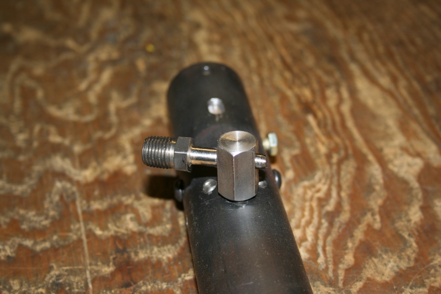

Finished check valve and barrel plug
Finished New check valve with probe style fill
