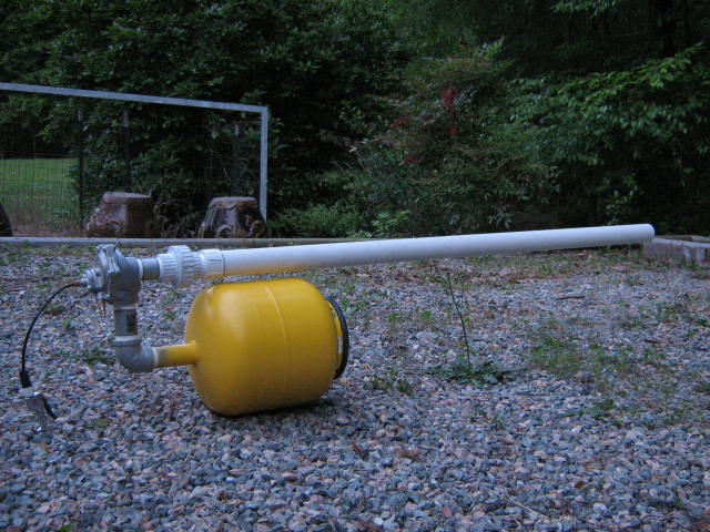

So, this is a cannon I made while I was at school in the welding shop. Its made from a 20LB propane tank and I tig welded the 1 1/2" standpipe on after using a dremel to cut out the old bung. I could have cut it other ways but I was worried about heat messing up the metallurgy. I'm guessing I could take the whole tank and standpipe up to the 250 psi working pressure of the tank but my ASCO pulse valve would fail long before that. Right now I have a 5' x 2" barrel on a 1 1/2" union fitting for storage. Only thing shot so far was a small nerf football and I never saw it leave the barrel. Actually I never saw it again even though I aimed for a tree. Needs a longer barrel since I'm going for the high volume approach rather than high pressure.
Sorry for the low light in the pictures. You get the idea though.

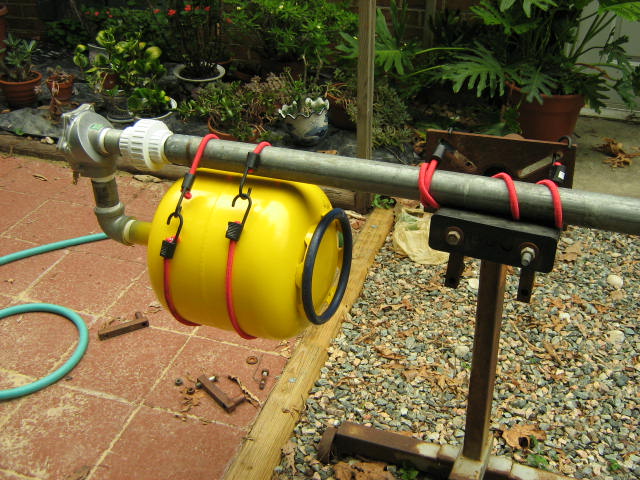

After a couple of months of the cannon sitting and me working and going to school I was finally able to scrounge a piece of 10 foot EMT conduit which now gives me my 3:1- C:B. There is an IPS nipple epoxied inside the conduit and the IPS fitting has some weld buildup studs that were turned down on the lathe as spacers. I shot it a ton yesterday (Independance Day) and it is amazingly quiet behind the muzzle but not so much down range. If a potato is too damaged over its length it has a tendancy to turn into potato salad in the barrel. (Note: my camera makes it sound 3 times as quiet, what you can't here is the echo in the entire neighborhood. Also I'm new to vid editing and am screwing around.)

It just looks so misproportioned. But way to go on the ridiculous chamber volume. It probably stays within 1 psi of the starting pressure throughout the entire barrel
That's why I dubbed it the Fat Banana, it just looks weird, I couldn't stop laughing while I had it hanging for paint. Super long barrel is on the way. I need to get a TB barrel ready and GB barrel as well as a longer full spud barrel (I hate half spuds 1.5")

Some of the pics used in the second video here. Since the video I have hip fired it and there is very little recoil even when shooting a full tube of caulk at a tree. The gun is so heavy with the 10 foot barrel that it recoils straight back only about 4 inches.
With all the big bores I have around here I can't shoot these things off as much as I'd like in suburbia and theres no way I can go for an altitude or distance shot either.
If I get the money I'll probably start going for high pressure piston rifles that are a little smaller and don't take so much space.
