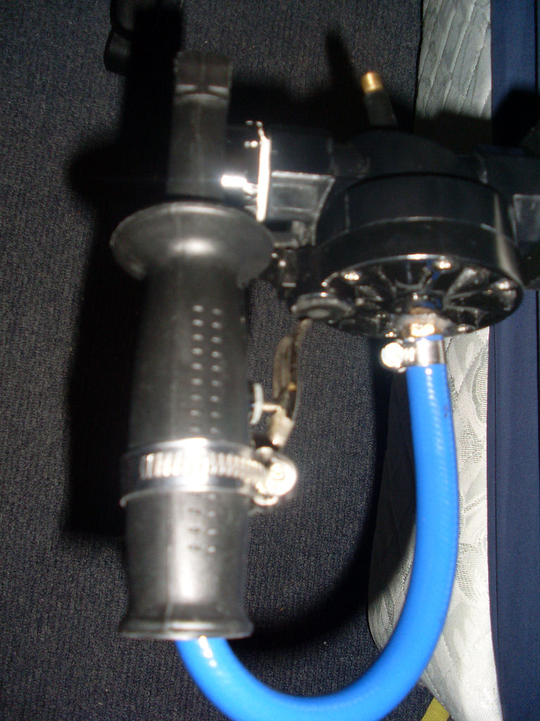

 Also the sprinkler is leaking quite a bit from the exhaust side of it, maybe the hose clamps or are slowly leaking and making the diaphragm seal leak, I'm not sure, hopefully the seal is just dirty or something.

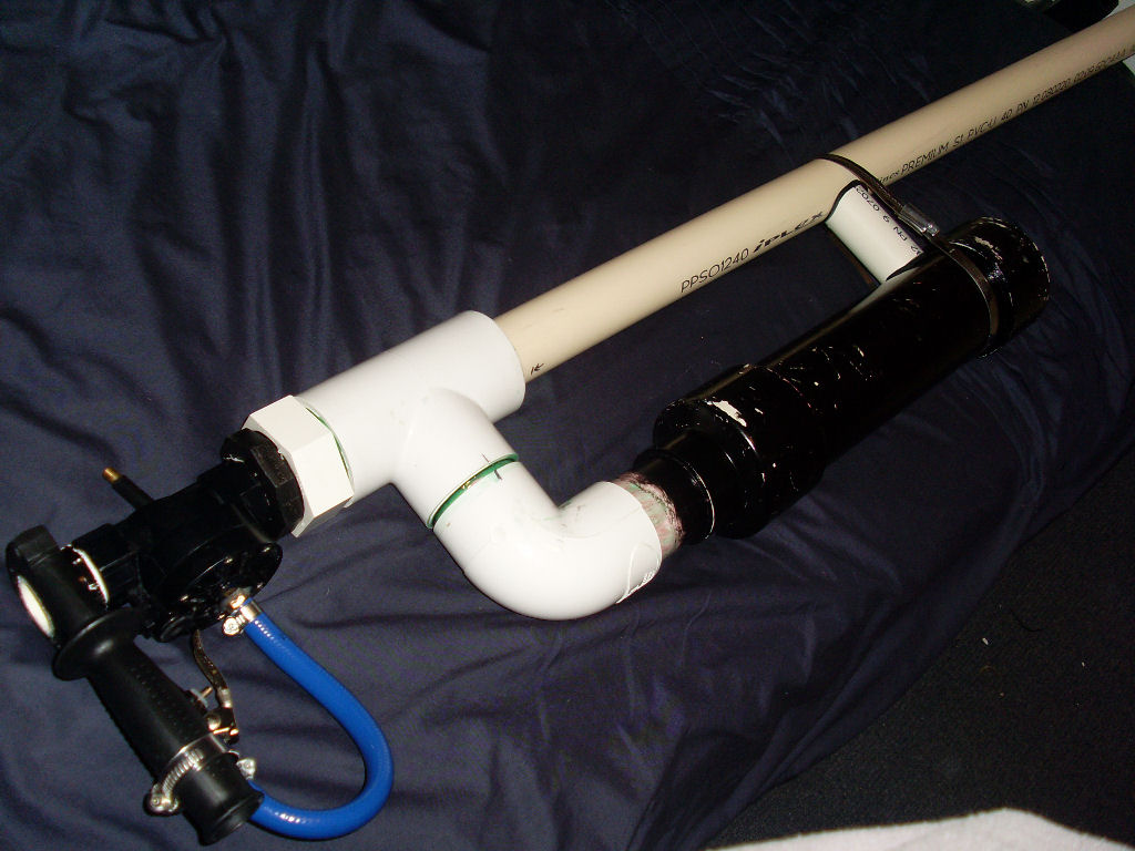

Ok heres what it looks like so far, haven't done the barrel support yet or painted

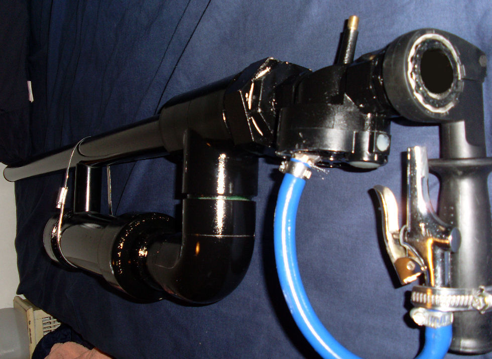

Glossy!!! A nice paint job for the paint-stripping gun.
