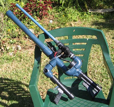

Like all the Hk series that there will be, this was designed to be portible.I have made the set up comfortible to hold and aim.It is a simple design with lots of added bits and pieces.Who dosn't like bits and pieces.
The specs:
40mm chamber 2 feet long
Hunter sprinkler valve(modified)
20mm barrel
blowgun configuration
adjustible stock
classic duck taped handle
bike tube filling valve
pressure gauge(removible)

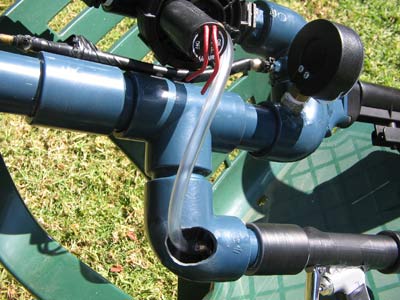

The chamber has two elbows one the end and that allows the sprinkler valver and the barrel to be on top of it (U bend). Although it might look like the T piece for the handle is linked to the chamber it isn't, the inside was filed down to slip over the chamber, this was done after I glued the chamber, thats why you can see a link on the chamber just in front of it. The filling valve connects into the chamber on the inside of the 'U bend'. I added an adjustible stock from a bb gun onto the back(it has all the whieghts removed) to make it look better and feel better.
(No Rambo this is not my paintball gun that I was talking about :P )
Feel free to ask about anything.

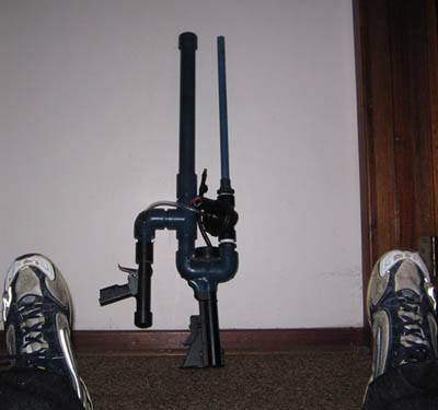

This is me lying down taking a pic of the gun.
This is what the gun looks like sitting on a chair 1meter away.

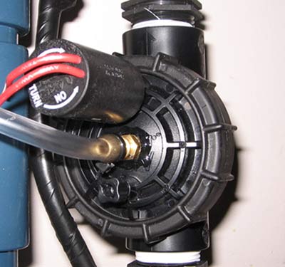

The spinkler valve is very easy to open, all you have to do is unscrew the peice surrounding it and open the diaphram, the modification literally took me 5 minutes. I left the solonoid on it just in case I want to use it.

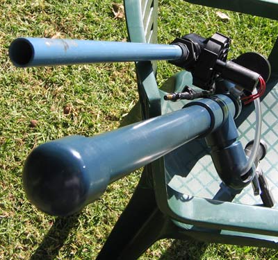

I took the blowgun and modified it into a 32mm pvc piece, it I want to disconnect it from the silicon tube comming from the sprinkler valve then I pull it off the elbow(it is not fixed but it will not fall off) and uncrew it from the brass pipe connection. It is also rapped in ducktape to give it a nice look.

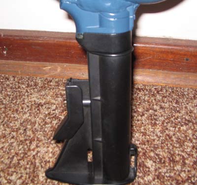

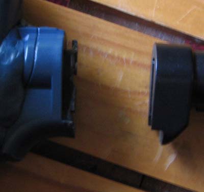

This is the adustible stock that I took off my bb gun, it can be removed at any time.

This is a close up of the modified sprinkler set up, you can see that I did what needed to be done to tuck away all the guts to make the gun look its best.

This is a view of the business end.

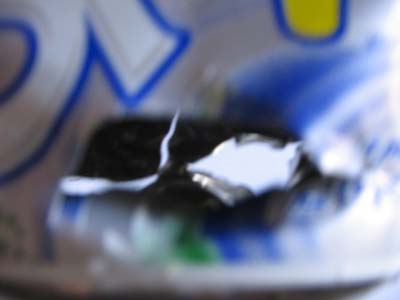

I get it up to 50psi befor the blowgun starts leaking, I think it needs a bigger spring inside or something.
this was a can filled with water.

nice M4 stock on that, how'd you attach it?
)DEMON(
Sergeant 4
Sergeant 4
Posts: 1391
Sat Jun 10, 2006 8:35 am
The one piece was attached with pratley putty to the chamber, the stock part fits onto it.
