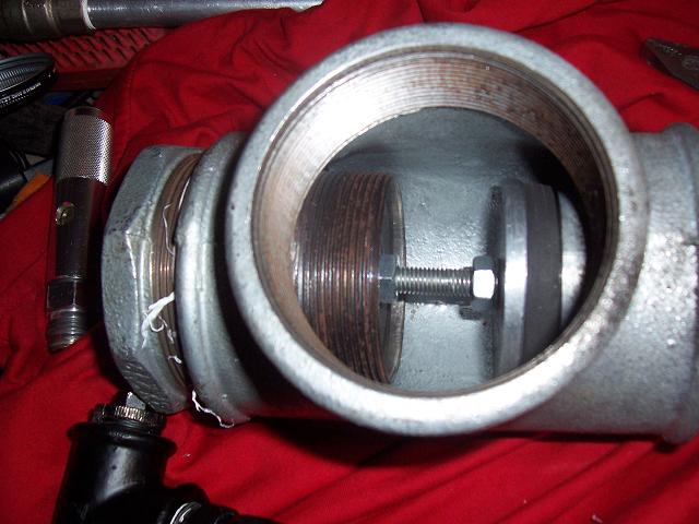

And the two inch porting metal piston valve that has been keeping me busy lately.

What pressures are you thinking of with using that 2 incher? Hopefully using that fridge compressor of yours? Or did yours break some time? I knew someones did.
