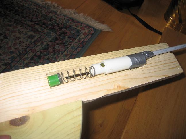

I wanted to make a gun that doesn't run off the air compressor so i was looking to try and make something like one of ant's designs with the ball bearing in a cap but i don't have the supplies yet so i went and made a spring airsoft gun.
My first attempt worked but without triggering system so you held the lever back and let go to shoot .

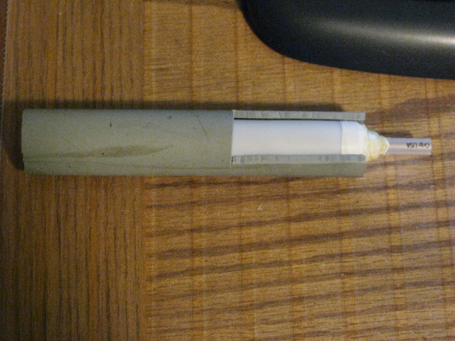

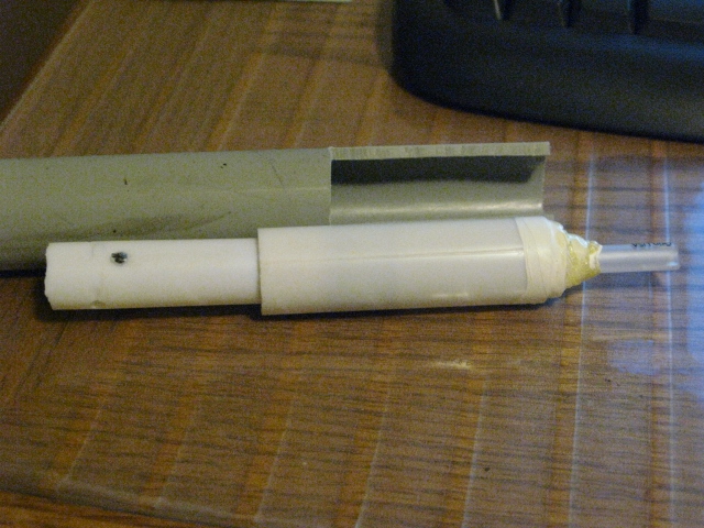

Im starting my second attempt using 3 tubes to allow for lever to return to original position, and allow for easier reliable reloading system.

Dude, that is a very beautiful gun lol.
I've been trying to make a springer But haven't really gotten around to it.
How's the fire power / distance, and post a video i wanna see it in action

Ill try after i get the new spring in... this ones pretty weak but i could shoot through a paper target with itlittlebro05 wrote:Dude, that is a very beautiful gun lol.

Not really, usually a springer is designed to shoot one burst of air out and as you can see on the diagram of JSR's theoretically the air will keep the bb down below it.
The point of three tubes are...
1 Outer Tube - Where the piston is kept in place andh elps with it gliding
2 Middle Tube - Is the thing that pulls the O-Ring'd piston back
3. Inner tube - The piston that creates a burst of air to push the bb out.
My designs abit different from yours but the good thing is that after you cock the gun the "lever" goes back into place.
the middle tube has a tube where it pushes and loads one bb like in a commercial springer, except my magazine won't be in the handle of the gun.

No, that's the beauty of the system. The blast of air from your piston (represented by the blue area in the animation) does two things, first of all it shoots the first BB down the barrel. Secondly however, you'll notice that the magazine tube is the same diameter as the barrel, so this means as it effectively acts as a sort of second barrel, with the air trying to push the BBs out of the bottom of the magazine tube.Ryukaji wrote:but once the first bb moves from the loading area wont another one pop in and shoot out too?
As the pressure from the blast reduces after the shot BB leaves the barrel however, the spring returns the BBs upwards leaving a new one in the barrel, and so the cycle continues.
