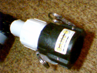

stud zooka is a pnuematic launcher that i made to launch heavier and more akward objects.
stud zooka has a 3" barrel for baseballs, t-shirts, and sodabottles & a 4"
barrel for toilet paper and softballs.
this gun is triggered by a 1" rainbird cp-100 and comes with cam lever couplings so i can easily attach and remove barrels.
the launcher is truly a stud. it's power is devastating at close range.

The large chamber was necessary so that I could use a large barrel to launch large objects.
I think you mean "why have a large 4" chamber with only a 1" to fire it".
I was a bit sceptical myself, but it really does fire hard & well.
Maybe it looks larger because it's an inline...

And yes i think the valve is a bit too small but i'm really starting to think it's not harming the performance that much.
would a homemade valve perform better? cause if it could i'd use the sprinkler for a later project maybe.

Try making a valve in a 3" T or something big. That would increase your performance a ton. If you want it to be really good you can use the sprinkler to actuate the 3" homemade. It makes it open extremely fast and dump TONS of air.
3" Tee's are too expensive I think, like $8 for a tee

would a 3" tee really be that powerful if it ony had 1" openings?
cuz that's what this gun would have.
but i don't think i need to change anything, this gun was a satisfying success and i was more than pleased with the results.
