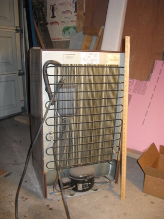

Ok, so I just got a fridge from a yard sale for free, and now I want to get the compressor from it. I don't really know anything about this, so I have a few questions.
1.- Where is the best place to start?
2.- What places typically release freon as a service?
3.- If one of those places can not be found, what pressure is the freon inside generally at?
4.- What are the dangers/hazards of freon (other than ozone damage), and what precautions should be taken.
Lastly, any tips or suggestions regarding fridge compressor salvage, etc. will be greatly appreciated.

I suggest that you juSt cut the pipes the freon will be at maybe 20 or so bar, if oyu just cut it do so in a well ventilated area and hold your breath if you are scared. Relly you jsut need to cut the compressor with the pipes and wires(un damaged of coarse) out, the rest is of no, or little use to you.

I just hacked through the lines.As soon as you hear a hiss, step back and wait it out.
Do it outside.
Unless ofcourse you find a method that is environmentally friendly.
Do it outside.
I would crimp each pipe as much as you can in a couple of places near the pump, so that hopefully it won't leak, then cut out the pump below the crimps. Hopefully that way you'll be able to avoid releasing the freon and can dispose of it safely.

Well you could jsut as well get soem one to remove the freon for you and then take the compressor depends on how ecofriendly you are, and they are starting to ban freon, so only a few more years that we have to put up with this then we can jsut let the gas out or set ti on fire(in the case of propane)

If it's like some other freons (eg. DCFM)- duster can freons they are so cold, that many will burn your skin, several ignite easily..all bad things to breathe in.
Do it outdoors, during the middle of the day when neighbours/family or whatever are out if you can. Then allow all the gasses to go off elsewhere (yes you're destroying the ozone layer, but no more than kids used to shooting green gas (propane) bb guns.. Then claim your compressor..done.
The most important parts being don't get it on your skin, don't inhale it and keep it away from flames in good ventilation.
I these precautions are taken, is it relatively safe?inonickname wrote:If it's like some other freons (eg. DCFM)- duster can freons they are so cold, that many will burn your skin, several ignite easily..all bad things to breathe in.
Also, where (which tube) do I pierce/cut and what is the best way to do it?

I think it is safe.. just do it outside
I made the first cut and then waited before it leaked out and then the second one... ohh and I used pruning shears to cut it out

normally there should be 3 tubes sticking out of a compressor (rarely there are more):
+ an air inlet,
+ air outlet
+ and the last one which was used to fill it with freon (it should be already sealed/closed off/soldered... so there is no need to cut it and you shouldn't do it)
it doesn't matter in what order you cut them as it is one circut (so all of them contain freon)
I'd do it like this (red is where you should cut)
+ an air inlet,
+ air outlet

Actually the freon in the fridge is neither poisonous or flammable. At sea level, it is very inert, and the only problem you'll have is asphyxiation from it if you do it indoors.
Propane is not a freon gas and doesnt harm the ozone layer, so kids can keep running about with BB guns (it is a powerful greenhouse gas though).
You can get it on your skin, although it'll be cold, and breathing small amounts isn't a problem, but it's not really pleasant. Freon is so non-flammable, that it was used is a similar form as a fire extinguishing chemical. It is extremely effective but of course totally ruined the ozone.
My advice would be to try and keep it in the fridge's system, if only for your conscience.
