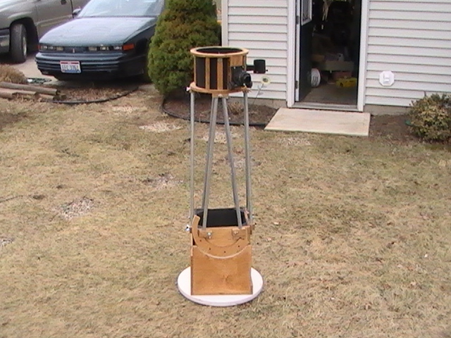

I like to go observing at night occasionally, and its easier with a bigger telescope. So a while ago i decided i would build a bigger one.
This is an 8" Dobsonian Reflector with a truss tube design to make it lighter. But while it looks like a telescope i have yet to find out if it functions like one, as i haven't set the mirrors in it yet. My dad make a 16" Dobsonian for my former science teacher, so i think i got everything right on this one. when i get time we will see if it works.

Nice Dobs! 8)
Did you grind the parabolic mirror or buy? I'd like to know where and how much if you bought.
Where can you get the mirror aluminized?
F5?
F5?
well, u see, some of the hardware came from a broken scope that was given to us as payment for the 16" my dad built. So, the mirror came from a meade Dob. I have read how to grind mirrors and it looks so delicate i would be afraid to do it. I was told that this mirror was ~$250, but i dont know how true that statement was, it seemed a bit low but im not a mirror expert.
