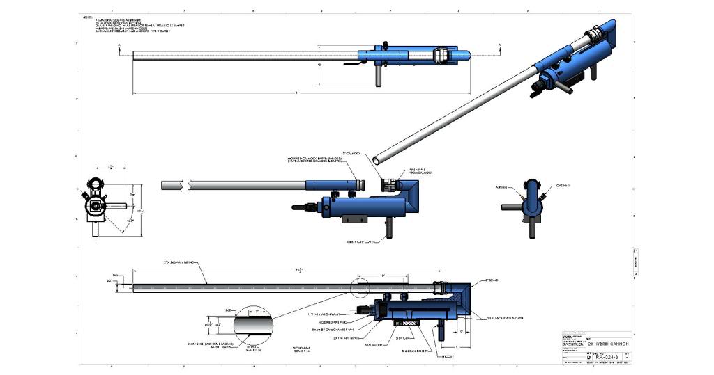

Introducing the "Cobra Venom" hybrid spud gun. If I am able to I would like make an insane pneumatic and perhaps a smaller piston hybrid for better portability and higher mixes.
(EDIT 10 years later, April 9, 2019. This cannon has served me with reliable performance for a solid decade. I just used it recently. This project was a 100% long-term success)
Specs:
2X hybrid/Advanced combustion
C:B Ratio: 1.22:1
Fuel-Propane/MAPP
1/4"NPT quick disconnect (Propane/MAPP)
Schrader valve (compressed air)
4.125" ID chamber X 18" long
1.87" ID barrel X 6ft long
2 spark gap spark strip
chamber fan-80mm 87CFM
stun gun ignition-150,000v
100% 6061-T6 aluminum construction-anodized, post weld anneal + T6 heat treat
2" Aluminum Camlock burst disc coupling & breech loading
1" ventilation valve-painted brass
1/2" X 12" Steel meter unit
Extras/misc:
Green laser (5mw) sight with pressure pad trigger on front grip
2" wide BLACKHAWK sling
UHMW bushings for smooth barrel movement
Black rubber grips
Modified project box enclosure with weather seal
Fan and Stungun toggle switches
Momentary pushbutton trigger
Bike pump with gage
Personal goal achieved:
Not a single hose clamp used and not a single wire visible on this cannon!!!! (besides laser cord)
PICS

Outstanding build! I know I'm going to spend the next hour and half downloading the video. You shared the plans and everything, there should be a award given for times like this! PROPS Moonbogg, PROPS! :wink:

Wow it's absolutely gorgeous. It seems to be pretty accurate also. How far away were you on the shots? Are you only going to 2X because it is pressure rated to that or because it would kick to hard? I wish I had the money and/or access to a machine shop.

lctchamp wrote:Are you only going to 2X because it is pressure rated to that or because it would kick to hard?
Same question, and...
Is your chamber made of PVC? I wasn't sure because it says "aluminum construction" above.

Whoa, thanks for the positive comments everyone! The cannon could handle more pressure. I just figured I would keep the factor of safety as high as possible.
I have never made a hybrid before so I was nervous with the extra power, so I started at 2X. I might go 3X, I duno. When I did the analysis on the cannon the aluminum didn't start to even bend until like 600psi or something, but that was a virtual test, not a real one. So I know I am totally safe with 2X, but it could very likely handle quite a bit more. Oh, but according to HGDT 3X would not provide much benefit over 2X unless I lengthened the barrel. So 2X really is the sweet spot for this baby in regard to power efficiency and safety.
There is no plastic on the gun, besides the project box. Its 100% heat treated aluminum for superior strength.

I suppose that the distance between him and the target was no more than 10 meters...
still the laser sight looks very very cool but it isn't really all that practical for long range shots... even with a quite powerful gun a marble (16 mm / 5 g) would need about 0.7 second to travel 80 meters (you can test it in ggdt and I tested it shooting today :-D ) so there is bound to be quite a lot of drop.. and lasers are no good for bullet drop

all of those CAD drawings make me think that the spuddign community is making a huge leap... now I have to mention what dewey does for the community by creating sketchup models of fittings and valves... I don't think he gets enough respect for what he does for all of us
