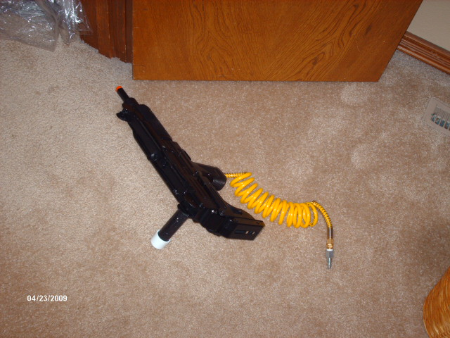

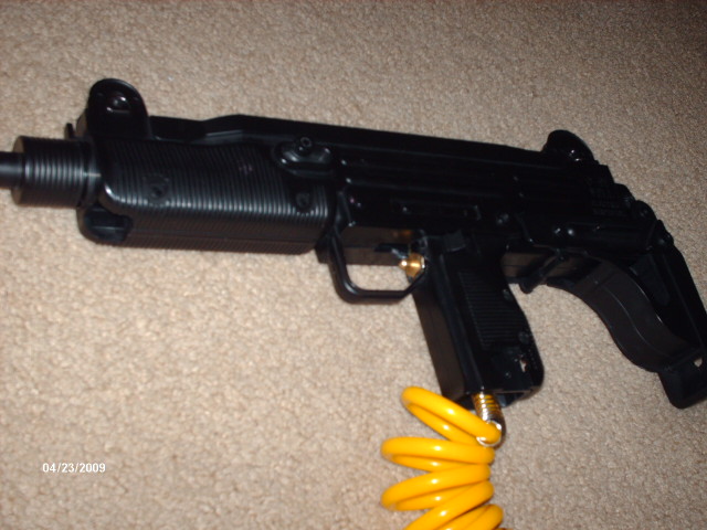

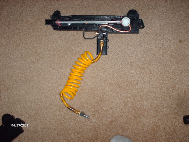

This is my vortex cap BBmg, it operates using a 3/4 pvc cap and fills with a male quick connect. The magazine is still being tweaked but as of now it is a 3/4 inch length of pipe with a spring in it.The blowgun trigger is in the same place as the original.
Magazine
Magazine
With Co2
With Co2
Trigger assembly
Trigger assembly
Inner workings
Inner workings
Overview
Overview

Cool! not the most advanced or breathtaking thing but must be brilliant fun to shoot at cans and such with..
Good job on a very clean build, what kind of damage do you get?
By the way what was the shell from? An airsoft gun I guess..
Has thanked: 581 times
Fri Apr 24, 2009 10:37 am
Very nice, you don't see many portable BBMGs, I'm guessing this is airsoft calibre. What pressure is it running at?
Why not eliminate the hose altogether though and have the bottle directly in the grip? Or have the bottle as a stock with a short hose?
Some damage vidoes would be appreciated :)

The damage is supreme,in fact it was too powerful so I have reduced power to enable me to play others without injuring them.

Are you left handed? If not, isn't that mag in the way?

Since this is such a small gun, I don't think being left or right handed will make a difference but does it?

I am left handed so its not a problem

The trigger looks abit uncomfortable to press o.O
it's like pressing the pointy end of a stick...
