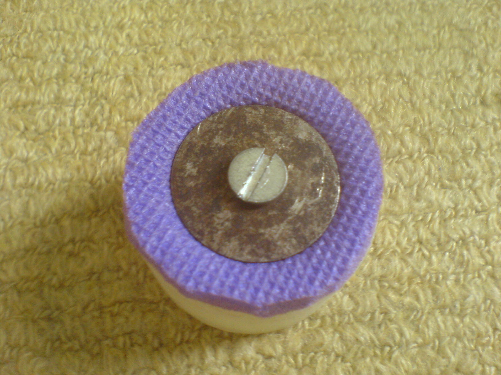

Here is a pic of the new nylon piston, with "unique" sealing face.

Jogumpie wrote:Here is a pic of the new nylon piston, with "unique" sealing face.
The squishy foam has 2 problems.
1) Getting a good seal with the waffle pattern to pressurize the chamber can be difficult to get a seal before pressure is enough to flatten it.
2) The soft foam is open cell so gas leaks through it and may get torn off when fired.
A smooth flat hard rubber washer may be a better choice, especially at higher pressures. You may want to test the product and be sure of the reliability.
Performance videos are good.
x2
I used this as my sealing face on my 3" piston:
Ultra-soft Polyurethane Sheet, 1/4" Thick, 4" X 4", 70 Oo Durometer
And it worked perfectly up until 40 PSI. Then after a few shots it was torn apart. I've been using a cheapo 1/8" neoprene fender washer found at the hardware store, and it's been working great ever since.

Ok, i'll look into sealing face alternatives.
Thu May 14, 2009 1:26 pm
Jogumpie wrote:Ok, i'll look into sealing face alternatives.
Even a piece cut from an inner tube would work better, but often this is not perfectly flat and smooth. If you are in the US, hit some True Value hardware stores. Some have sheet neoprene rubber by the sheet.

I could NEVER find small amounts of neoprene or similar in the UK. I asked in 3 auto stores, and asked a few ebay sellers for samples, but had no luck.
I used inner tube in the end, with a penny washer to keep it from curling off the piston face.
