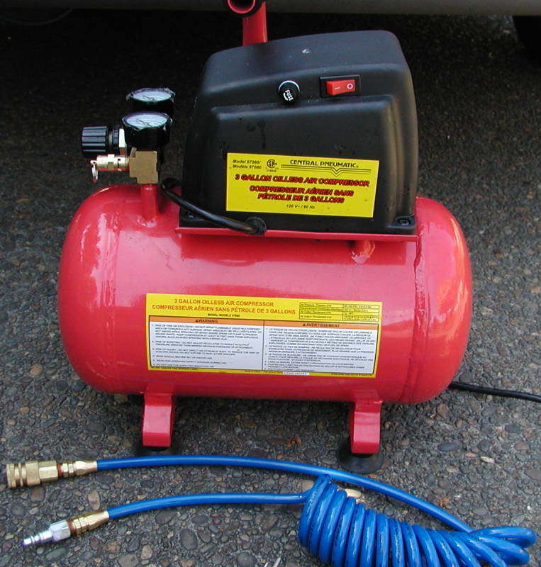

I have picked up the 1/3 HP 2 EDIT 3 gallon compressor  from Harbor Freight and did extensive testing this weekend.  It works great.  It is this one that was on sale for $59.95.
http://www.harborfreight.com/cpi/ctaf/D ... mber=97080
It has no problems re starting on the inverter at the cut in pressure.  The delivery is just enough to keep up with the reload cycle of the marshmallow cannon.  We had a ball with the 3 foot tennis ball barrel and emptied a bag of tennis balls out in the field in no time.
The large cannon was another story as the chamber is about 3 gallons and the compressor is only 2 gallon.
Tag said 2 gallon, compressor clearly marked 3 gallon An initial fill to 40 PSI is quick, but then the compressor runs for a long time to bring up both the compressor and cannon's combined volume to 70-80 PSI.  The wait isn't too bad, but the compressor runs constantly and we wait for the pressure to build on each shot.  It is about as fast or faster than hand pumping it.  It is well worth the money for the field launching.
Edit, after a weekend of shooting, here is the field power setup.
1 Prius
1 Trunk Mounted 1KW inverter
1 2 (3) gallon compressor 1/3 HP
1 Air Cannon
1 Light for night operations
Compressor takes 3 minutes to reach 100 PSI from empty.  Pressure drops to 40 PSI on initial cannon fill and takes another 3 minutes to reach 70 PSI for a 3 minute cycle time for 60-70 PSI shots. Longer for higher pressure.
The marshmallow cannon is better.  Compressor takes same 3 minutes to 100 PSI, but only drops to 80 on filling the marshmallow cannon.  It's almost back to 100 and shut off by the time the next shot is ready for pretty much continuous shots.  Did a Tennis Ball cycle of a dozen tennis balls with the 36 inch barrel and the compressor kept up, but didn't cycle off.  The inverter and compressor held up well.
It is a little slow for the big cannon, but much better than the hand pump where most people petered out at 60 PSI or less.  It was consistent at higher pressure and faster.
Compressor did not come with a hose.  I just used the one I had on my hand pump seen elsewhere.
