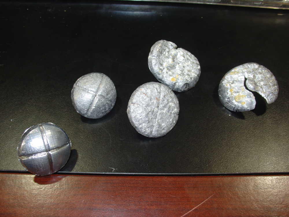

Here's some photos of the recovered lead. Notice the variance depending on distance and object struck. The left one is un-fired for reference. The real flattened ones were from hitting the carpet right where its draped over the boom to get the initial sighting dialed in. There is some carpet embedded in the lead. The carpet did a great job slowing the rounds down and allowing them to be re-usable.Gaderelguitarist wrote:Are you planning on making a round with a harder, sharper nose for piercing purposes? I think that would be the next step.

We will get some damage video up soon.
Right so the plastic is good for many uses, bu for most targets (the average ones for spudders at least)the led is a one use.
