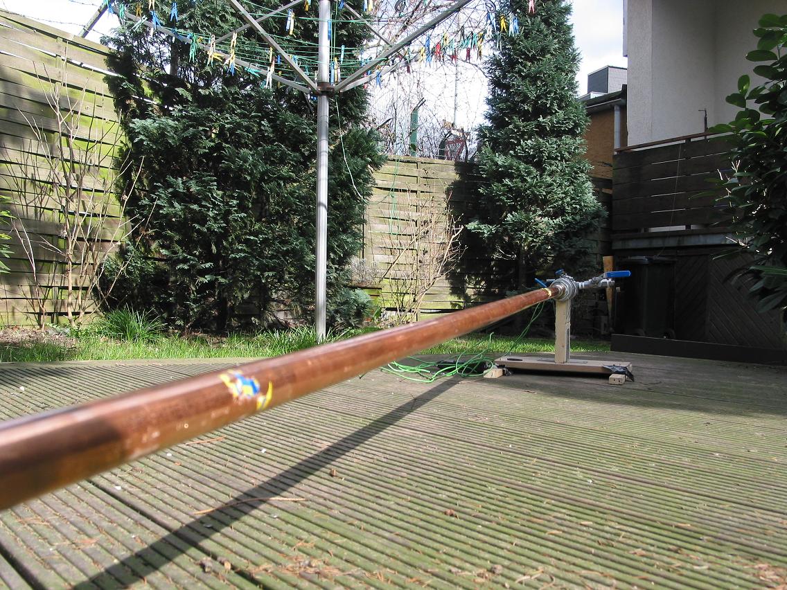

This is my first hybrid. I hope you like it.
Barrel: 2,5m long, 26mm ID, 28mm OD
Chamber: 20 cm long, 2'' diameter (about 660ml)
Ignition: Sparkplug + Stungun
Burstdisks: Alu. foil
Ammo: 200-500g lead
Mixes: 8-18x
I built this cannon about 5 months ago. Back then i had to use my bikepump and was limited to 10 bar.
Using a 243g lead projectile at 8x my Chrony measured 62m/s which should be ~470 joule if my math is correct.
A few weeks ago I finally got my fridge compressor and now I plan on taking it up to 20x.
I was only able to fire it one time at 18x because im having trouble sealing it above 16bar using Alu. foil as a Burstdisk.
Maybe I will try soda cans or something else next time.
Greetings from Germany

vince wrote:Using a 243g lead projectile at 8x my Chrony measured 62m/s which should be ~470 joule if my math is correct.
Your maths is correct, but that sounds very low for an 8x hybrid with a barrel of those dimensions. As an off the top of my head guess, I'd expect 3 to 5 times that muzzle energy.
This may be indicative of either a problem with the chrono (possibly how it's being used) or a performance inhibiting factor in the cannon, like blow by in the barrel, slow burn rate, bad fuel mixes or a poor C:B ratio.
On the note of C:B ratio, I have to say that from the pictures, that doesn't look like a 730 ml chamber - it doesn't look like it's 30 cm long.
This is impressive, but I'm sure you can get more out of it.

@Ragnarok
You are correct. The chamber is in fact only 20cm long and has a total volume (with the T with the Sparkplug in it)
of 660ml. Im sorry I got it wrong and I edited my original post.
Im really having some problems with my Chrony at the moment. I measured at least 8 shots with similar projectiles (240-250g)
at the same mix and I got readings from 63m/s to 250+m/s so I assumed that when I got the high readings the Chrony was too
close to the end of the barrel and that screwed the measurement. So I just went with the lowest reading of 63m/s ;)

Well, the lowest reading isn't necessarily the correct one either - muzzle blast can screw it either way with the higher velocity gasses of hybrids. Personally, I'd take figures in the 110-140 m/s range as likely with a cannon like this.
