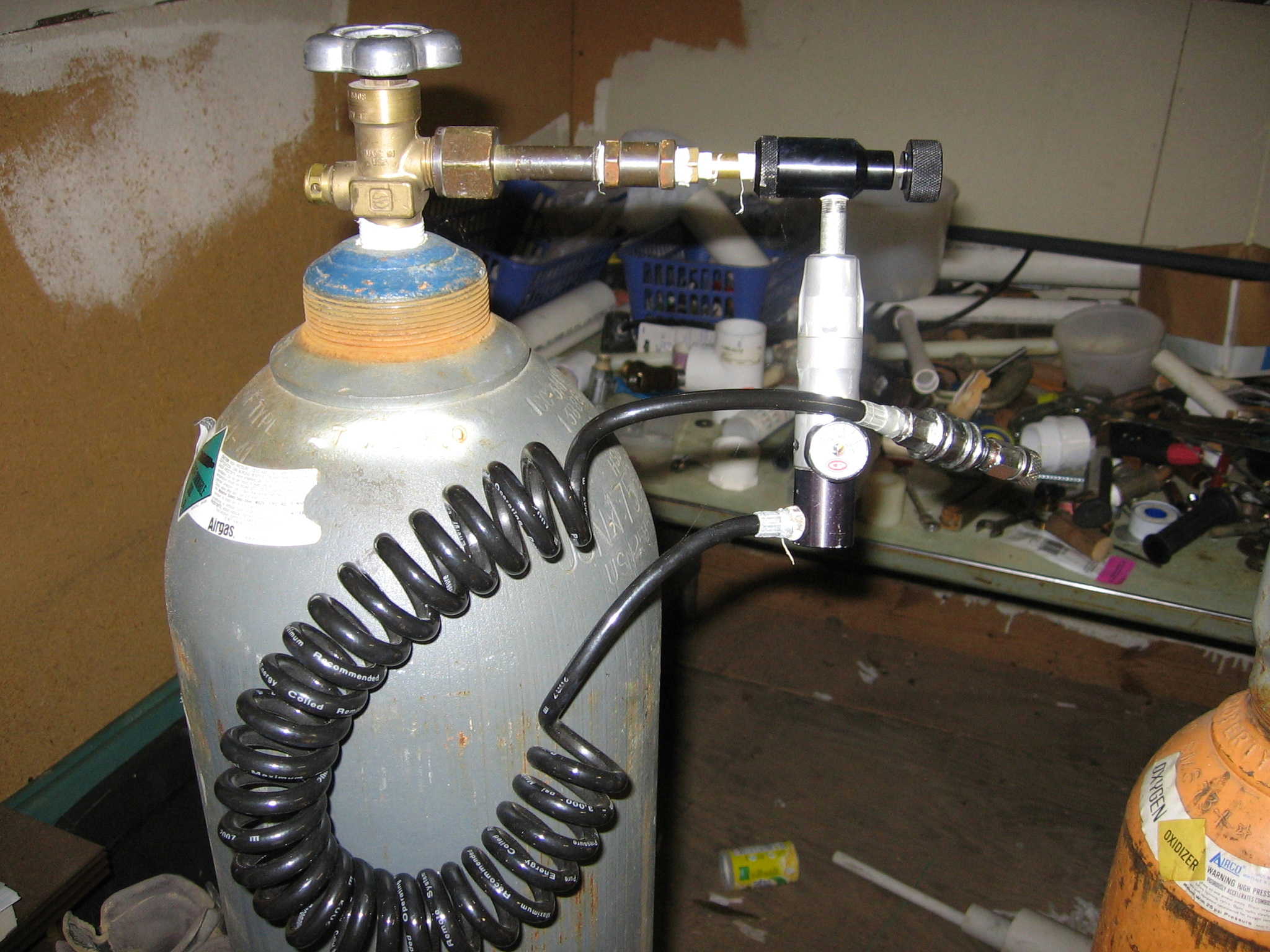

Some better pics of overall size and layout, as well as the fire control that will be upgraded soon... Also a pic of the c02 adapter setup I use to fill with....
I've tried to get readings 3 times, but at 6ft away firing 16" above the chronie, the muzzle blast kept knocking the chrony off the stand, I'm going to mount it to a steel plate 12"x12"x.125"thick and clamp that to the picnic table...
