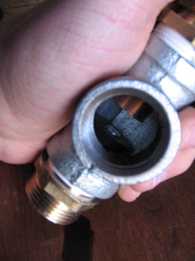

I have started constuction on my valve and have some pics. I am not sure if the piston is too long, how long is your one? I have done all I can do so far until I can go to the hardware store and get more fittings. So what do you think of it?
The fire extinguisher has irregular threads so I will have to wait until I get my welder.

This is the inside of my valve so far.

The inside shot of the valve looks okay,
but the piston and it's housing are too long.Big pilot volume :cry:
Get those compression fittings as close to one another as possible.
I didn't see a shrader...are you filling from the back??
I have my doubts on the excaust valve aswell..either the hammer valve won't open because of too much pressure, or, if the surface that opens(?) is small enough to be opened against the pressure, the flow will be too little.
are my english skills deteriorating or what?? Didn't know how else to explain it.
I'm not trying to be negative, I just wanna help you out

Ok, I will shorten the piston and housing,thanks. The fill valve and stuff will be behind the piston of course but like I said, I haven't got all the parts yet. The exhuast valve works well, I have used it befor ( it has much greater flow rates than a blowgun). I know you are helping me and I appreciate it greatly. I also am thinking of using a female quick dissconect instead of a schardar.

I did what you said and shortened the piston housing, I also put 20mm pvc inside it for a really snug fit. I am happy with this,everything lines up.

Mon Jul 17, 2006 5:47 pm
looks better now don't it! :D The piece of pvc should give the piston a smooth ride!
Just a question
What diamiter barrel are you using? Isn't it too close to the piston diameter? The piston should always be bigger you know. :roll:
If that's okay then you have the right material to build a super fast valve.
I wish I had those fittings over here man!! :D
I think you could ( take a good look at it before you even try) take a piece off the barrel, so it doesn't go into the Tee as far as it does and just extend the 20 mm pvc further into the Tee.That way you might even mount the excaust valve directly onto the connector coming out of the Tee.
Shorten the piston some more and shorten the spring.If you can get that to fit it would actuate incredibly fast.Maybe try it with some leftover pieces of pipe first.Don't cut the barrel until you know if you can fit all the parts in.

I will do some more designing. The 20mm pvc only fits in the larger copper pipe but maybe I can just put an adaptor on the fitting that has the larger copper pipe in. The piston is the same size as the barrel, is that a bad thing?
I can move the barrel forward without cutting any peice off, it is not fully crimped on. I will post more later.
CHANGES!
I shortend down the piston and got rid of the copper piston housing when I found out that the fitting was holding the 20mm pvc. I am going to place a tee on it with a female quick disconnect coming out the bottom and the pilot valve on the other side of the piston. I moved the barrel forward a very small amount.

Here is a pic of the internals.
