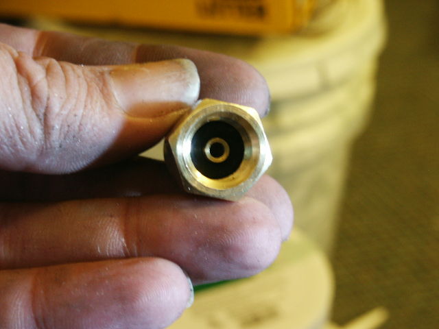

Tue Aug 04, 2009 11:51 am
The rubber can be turned down a little in a drillpress and installed into a pipe cap. The rubber would then form a gasket as it screws down onto a pipe nipple.
Example photo attached.
Fill valve installed
Fill valve installedwiki.JPG (22.28 KiB) Viewed 2594 times
Bottom view showing the rubber seal.
