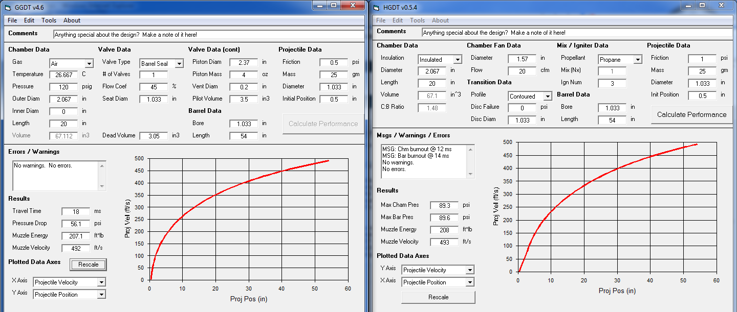

Back when I was a complete newcomer to spudding, one of the first differences I noticed between typical combustion launchers compared to pneumatic launchers was size. Combustions are usually pretty big and cannon-like while pneumatics tend to be smaller, less bulky, and more gun/rifle-like. Of course, there are advantages to not being bulky. For example, my pneumatic is lighter and much easier to aim than any of the larger combustion cannons I have built. This makes it much better when I want to try shooting targets from more than a few yards away.
The disadvantage is that I am stuck with a bike pump to pressurize the thing. I live in a very residential area, so using my back yard as a firing range isn't a good idea. I usually go down the road to an abandoned dump for all my spudding, but there is obviously no place to plug in a compressor which means I have to pump. It's a great workout, but it really gets to you after 10-15 shots...
Anyway, I started wondering how a similarly constructed combustion would compare to my pneumatic as far as performance. So, out of curiosity, I did a quick estimated comparison using HGDT and GGDT. I figured the pneumatic would cream the combustion @ 120 psi (barrel sealing piston valve), but I was wrong. The muzzle velocities turned out to be about the same. I used 120 psi as a reference since my gun is made from PVC and that probably about the max pressure I consider safe.
I have only seen a few smaller size combustions in the showcase. However, elitesniper's advanced extreme small combustion seems to perform very well and similar to what I had in mind. Of course, simulations don't always turn out to match the real thing. Has anyone else looked at this?

niglch wrote:I have only seen a few smaller size combustions in the showcase. However, elitesniper's advanced extreme small combustion seems to perform very well and similar to what I had in mind. Of course, simulations don't always turn out to match the real thing. Has anyone else looked at this?
Pressure is the big issue. When you go down in calibre, the surface area of the projectile (which the air or gasses act upon to push the projectile) goes down exponentially, ie if you go from 1" to 0.5", the area has gone down to 25% of the original. This means that to provide the same force, pressure has to increase by 4 times.
With combustions, you're stuck at pretty much the same pressure so by definition, the smaller you go, the less powerful it will be. Pneumatics on the other hand give you the option of upping the pressure, for example my pengun type launchers would be absolute manure as a combustion, but a small chamber at 400 psi gives them enough power to be worthwhile.
Another thing, the pneumatic you modelled can afford some optimisation, for example the pilot volume should be below 2 cubic inches, the pilot valve is very restricted and in a piston valve you would expect dead volume to be zero.

A well made combustion, especially if it is the optimal combustion size range, will usually outperform a poorly made pneumatic of similar dimensions. For example a pneumatic with a ball valve usualy isn't all that much better than a combustion, and often isn't even as good. If the pneumatic is pressurized with a typical shop compressor then that ~120 PSI limits the performance to about the same as a combustion.
The big advantage of pneum'os is the ability to go to much higher pressures than the ~120 PSIG limit of 1X combustions.

As far as the side by side comparison shown, well done. Chambers are most often not insulated. Many combustions are not optimum. In a side by side with a combustion (spray and pray) of the same size as my ABS pneumatic, we were pretty evenly matched where I was running about 35-40 PSI. At higher pressure pneumatics most often beat spray and pray combustions.
