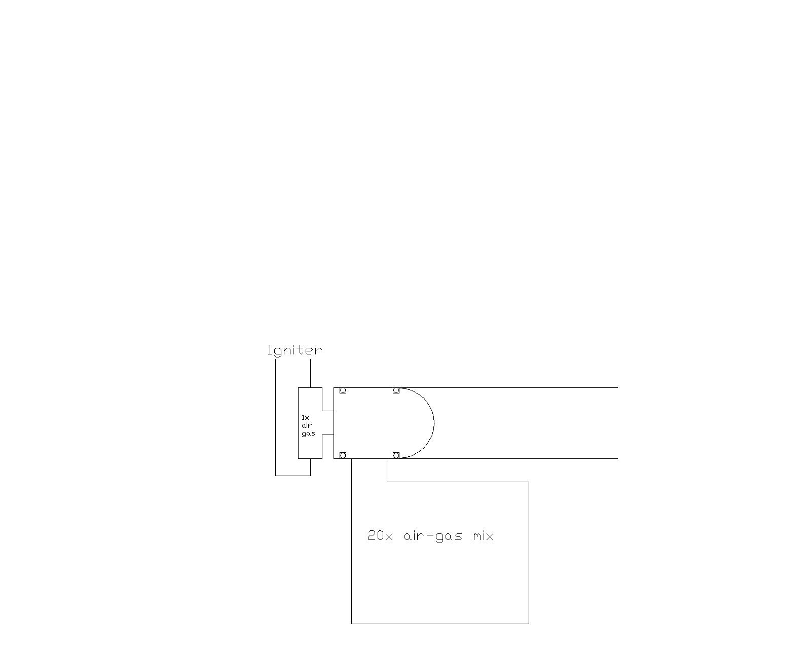

Thought about building something like this with our original twin O-ring designed UHMW rounds... So the pilot could be a simple spray and pray. worse case scenario the sudden increase in pressure could extinguished the combustion and it would a pneumatic with a combustion operated pilot...
crude, but you get the idea.
