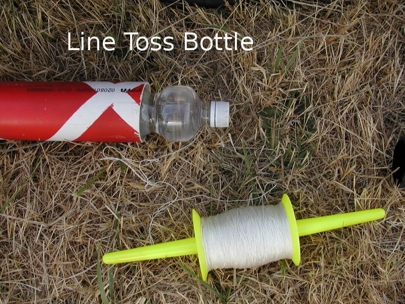

I launch water bottles out to the end of a 500 foot mason line with no problems. A proper cannon and heavier projectile can tow a heavier line just fine.
Kite string as well as mason line works fine with a bottle of water.

This one that is getting a fill in my trunk. 3 gallon tank, 2 inch QDV valve, 2.5 inch 7 foot thinwall barrel.
Use a sparkling water bottle like White Rain. They don't burst on impact like the cheap thin ones. It was really hard to hit the tree. It took several shots. Our aim wasn't great. We did hit it dead center once in a couple dozen shots.
