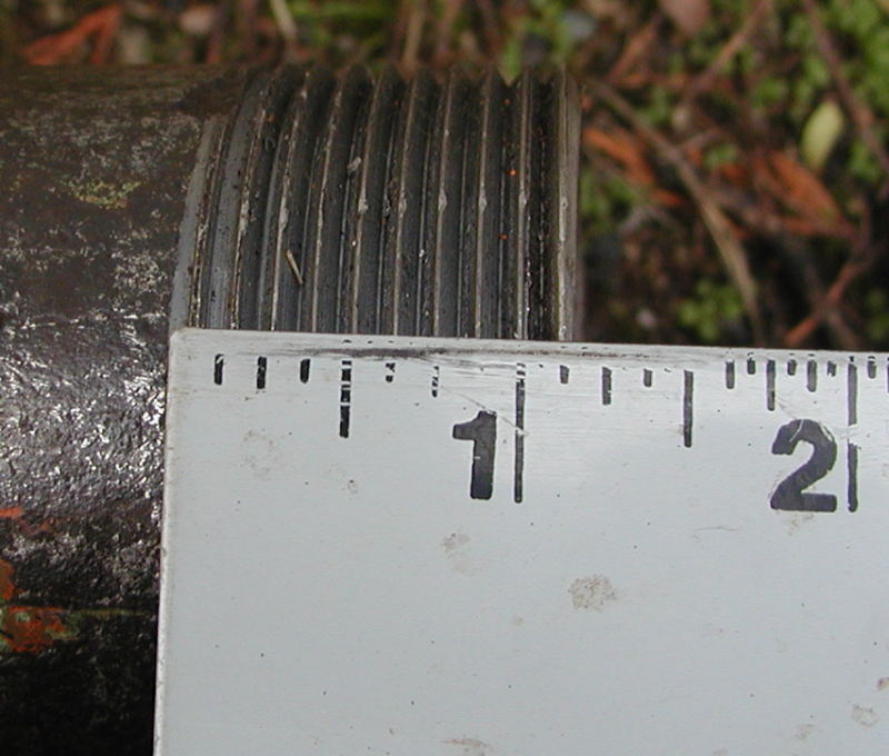

Length of threads.
Length of threads.

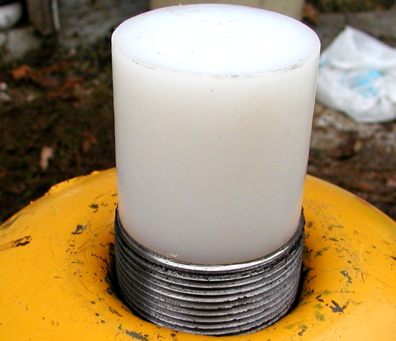

This piston diameter gets fixed this weekend.

Piston is 2.684 inches long.  I get to turn it down this weekend on a lathe.  No need to measure the current diameter.  It's too big.

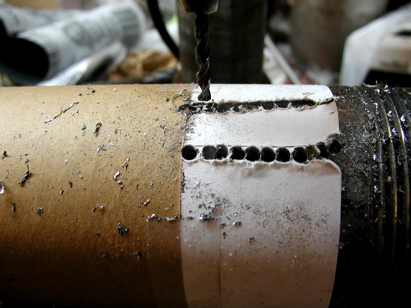

Port cutting is finished.  A little de burring and edge rounding will finish the job.
First piece is removed.
The other sides are marked with a hacksaw.
Pattern transfered by drilling the lengthwise cuts.
Divided into thirds by folding.
Distance is measured with a piece of paper.
