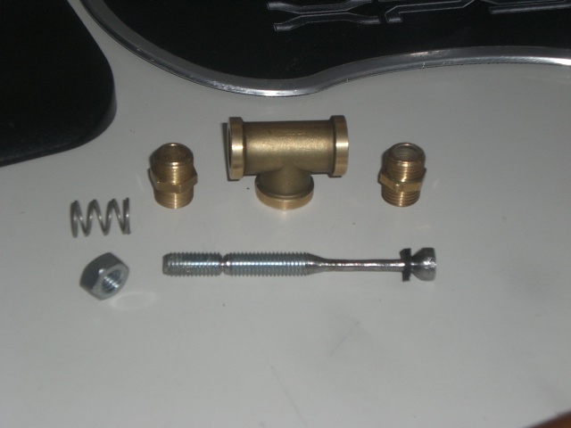

hi I made a hammer valve for my upcomming pellet sniper
the diagram is made by BTB
it's made from:
a 1/4" T
2x 1/4" nipple
spring
bolt and nut
2 different sized o-rings
in the groove you see there's a o-ring now
I hope you like it :D
(has anyone a picture of an other Thammer valve?)

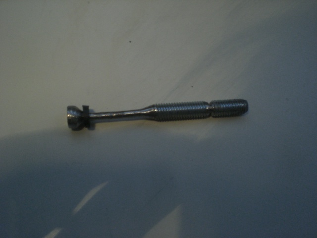

Looks promising,
Buutt... When I initially test fired mine, it worked fine at "lower" pressures.
With un-regged CO2, it blew the o-ring "up" the stem. Had to take it all apart to find the problem, and then make a whole new valve stem to solve it.
The new valve stem has a teflon sealing face, which is retained by the shaft threading into the "head" of the valve.
Works perfectly now.
You may, or may not run into this problem. It depends on the pressures you plan to use.

ok
well I was thinking of pressures from about 30 bars
the small o-ring has has chance of coming out but I'm pretty sure it won't. the sealing o-ring is now glued to the nipple and there isn't that much of power acting on the ring it self when the valve opens
we will see when I get a chance to test it

I tested it and there good and bad news
the bad news is that the o-ring which was glued came loosse due to the pressure :cry:
the good news is that at 10bars the last little poof of air was about the
35th!
