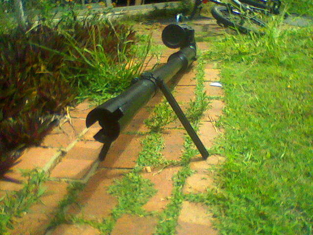

this is before the new end cap.
front
front
side
side
