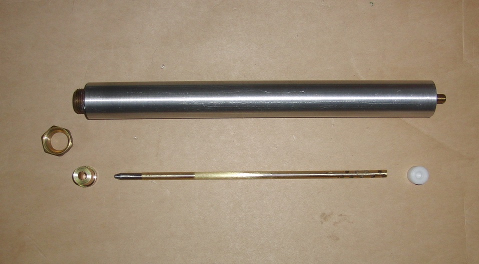

I made my own variation of this design using a coaxial :)
In the first shot in real time, you can hear the air leaking out past the captive sabot (or cabbot as we're now calling it :D) after the shot. There's noise from the pilot exhaust and the impact but it's much, much quieter than when it's shot as a conventional launcher.
The "arrow" is a 6.5mm OD brass tube with a mild steel head, total weight is 22 grams. The perforations at the end are incidental because the tube is a recycled barrel from another project, but what they do is allow air to escape at the end of the piston's travel, reducing the air bumper effect. In spite of this, the delrin cabbot is undamaged many shots later, probably due to the relatively low velocity from the heavy projectile.

Edit: another video, chronied it this time. At 250 psi, it's humming downrange at a mere 87.5 feet per second. That's only 5.8 ft lbs, so anaemic that it would be legal as an air pistol in the UK! boooooooooo!!!
