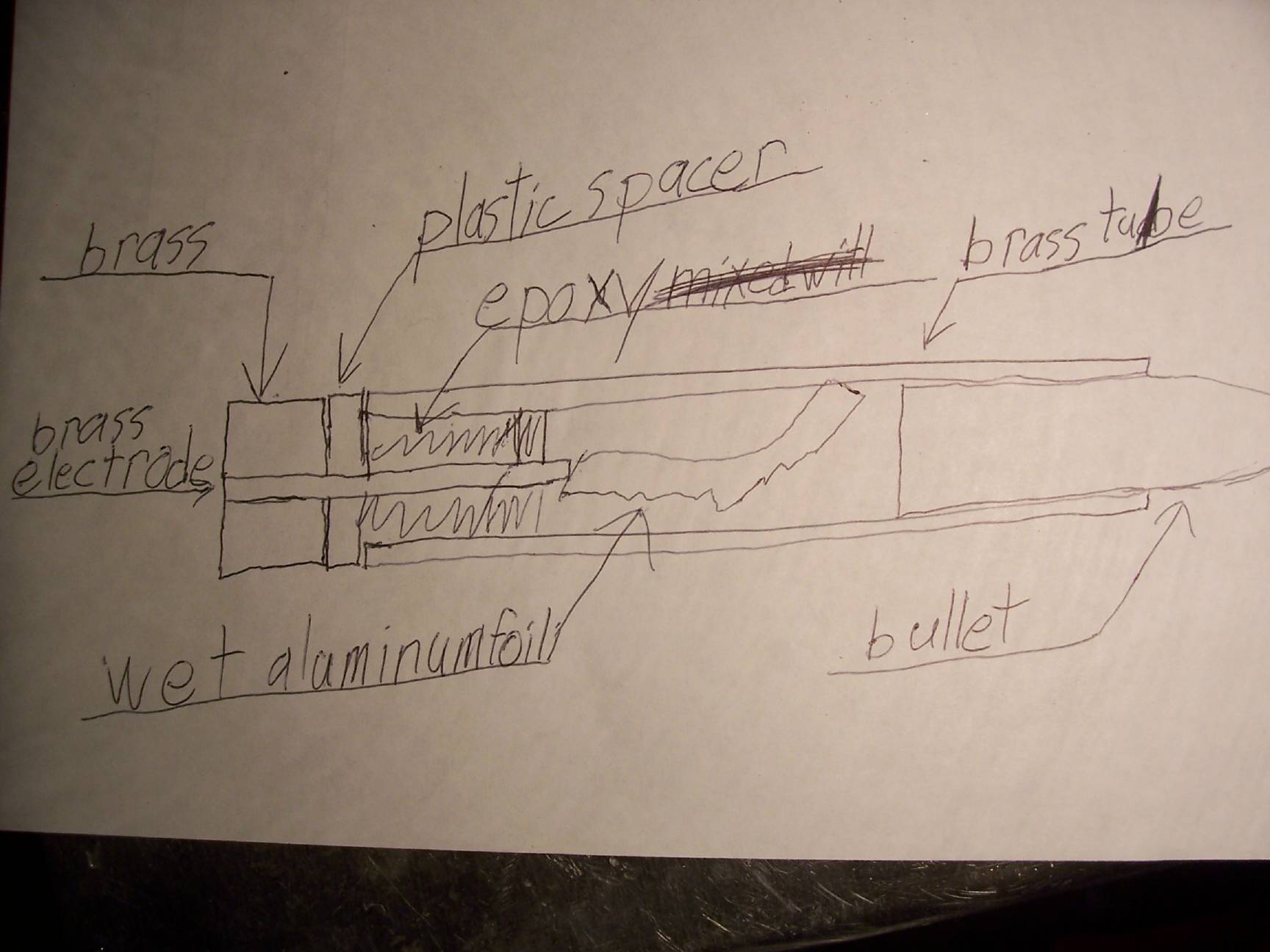

Good work 245Tommy, not many people have this much success on their first try at an ETG.
It would be nice to have some more specific details on its operation though; what the propellant gas is, and how it is generated (my best guess based on your design is that you create an arc through the propellant to ablate it) are what I'm most interested in.
Also, it may be worthwhile for you to try a simple ballistic pendulum test to try to measure muzzle speed/energy.

Actually, my first etg used a cut up co2 cartridge as a barrel and chamber, and it worked alright. The propellant is a 5x22mm shred of aluminum foil dipped in water bridging the screw electrode to the barrel.DYI wrote:Good work 245Tommy, not many people have this much success on their first try at an ETG.

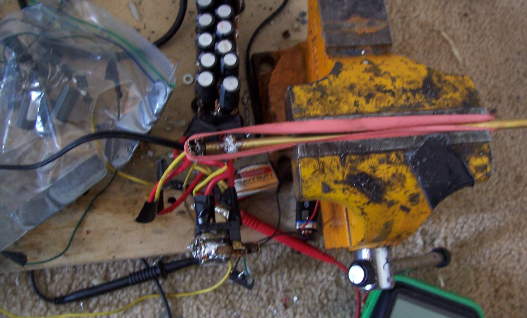

Looks promising
will the cartridge eject or is it a locked breech?
eff offqwerty wrote:I think Jacks getting a bit jealous, Common tommy say some more stuff about how amazing it's gonna be
Hmm... interesting...a sideways swinging hammer
Holy mother of jesus.
Lookin good. i wanna see the cartridge shoot now
I like your "bolt spring"
any chance of a video?
