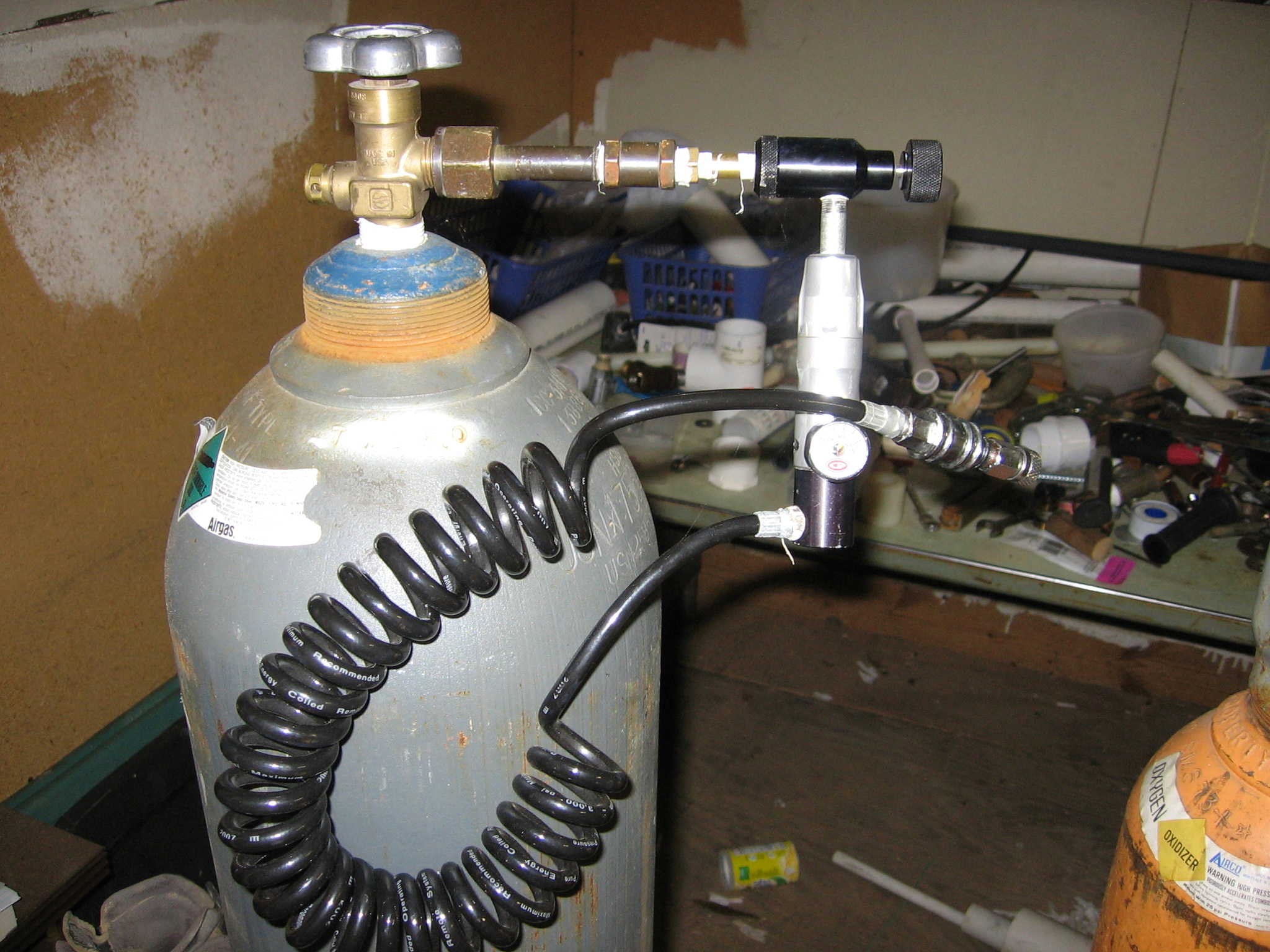

Here's my setup... It'll work for paintball co2/hpa tanks or bulk co2 tanks(with the adapter)... The reg was 79 and the remote hookup kit was 49, the co2 to 1/8" adapter was given to me when I leased my big tanks...
My Cannons can be found by clicking the following link.
