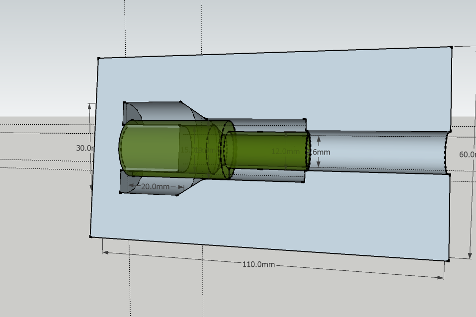

The idea is to combine both the main valve and loading mech into one block of aluminium.

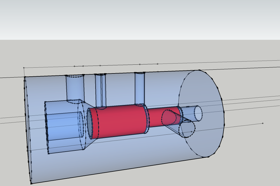

The end product would be a relatively small aluminium cylinder more less the size of the machined T on the semiauto MKIII (probably not larger than (60mm diam X 110 length for 10.4mm calibre). There would be a couple of ports in it: for the barrel, mag, 3 way valve (used as a trigger), HPA source of air and one for chamber extension (optional).
IMO this thing would be a huge step forward in terms of compactness, simplicity and power (since the idea is to optimise it to use ~800 psi or more)

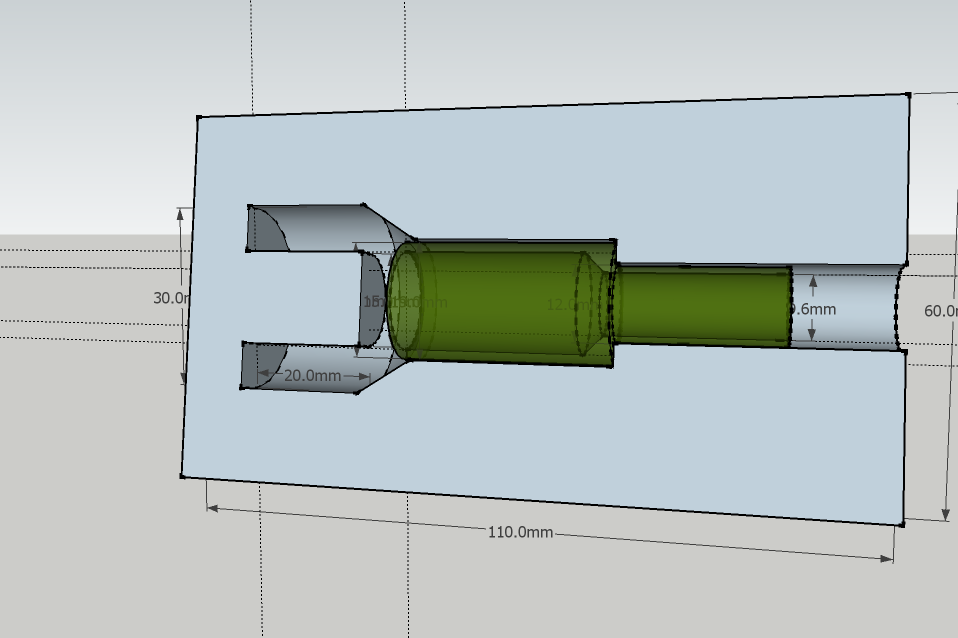

I've been trying to come up with a design that could be easily (cheaply) machined. SOmething that could be created from a bar of alu and would require to cut only to drill a couple of holes and ports in it and to lathe the bolt. So far this seems to be most promising....
it's based on this Image
but I modified it so that I could be controlled with a 3 way NO valve fed with regged down air
The only problem is to optimise it so it would be cheap to machine. There are a couple more problems with it, such as o-rings...
NOTE not everything is included in these models. Some lack o-ring grooves or some parts are not precisely postioned - I still have to improve them
yeah I know that some of the ports are not ideally placed

The o-rings would need constant lubrication or they would break up, they are a stationary type of seal. You might think about lengthening the cylinder the bolt slides in, it looks to me like you might have a problem with air escaping through the bolt before the piston can make the seal.
That would also give the bolt better stability to line up with the piston. Other then those two things it looks like a workable idea. Nice design, I like it!
Sun Feb 14, 2010 9:50 am
yeah I still have to improve it and make sure that all the dimensions are right
I think that paintball valves work well without lubricated air.. I guess I could lubricate them from time to time
also someone suggested dividing the housing into two parts and joining them via bolts...
supposedly it could cut costs but I'd like to know what is you opinion?
I am leaning towards this option as it would make creating the stationary oring seal between the LP side and the T much easier
(ohh in fact there already have to be two parts - as you can guess this valve would have to be serviced somehow so the bottom would have to be screwed in

Saw off the back 3rd so the piston has a strong anchor, using 4 to 6 machine screw's/bolt's with machine thread to hold it on. That would make the ports easier to machine.
I would do the bigger part 1st making the smaller part of the port easier to center. Dewalt makes drill bits with built on pilots, the perfect center marker. They are costly. I paid all most 6 dollars for a 1/4 inch bit but it made the work easy and quick justifying the cost, it made it's money back 3 holes drilled!
You could lube the o-rings with what ever kind of packing greese. The front o-rings are not under the kind of condictions where the lube would be blowed out like the rear o-rings near the bolt.

The one thing I don't like about this design is the reliance on o-ring seals, most of which are exposed to friction and therefore wear. In this regard, and ordinary QEV + blow forward valve would be more reliable, but this offers a neater and more efficient setup. The fact that you need two air sources is also a little awkward, this is from a personal perspective of trying to keep everything as simple as possible.
