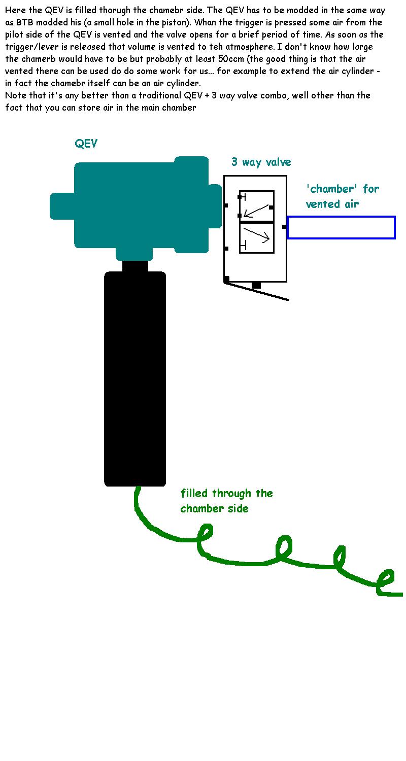

have a look at the pic there...that's basically all you need to get achieve semiauto with a QEV gun (ignore the loading mech there... all you need is a QEV gun + a 3 way NO valve)
Alternatively, as I said earlier in some thread, you can get the same result that BTB achieved on his shatterhand but without a hammer valve...
(that is multiple shots from air stored in the chamebr only... though it does not give you extra air or more shots in any way.... you just keep all air in the main chamber instead of having a separate tank, which might be useful but not in every case)
you'd have to mod the QEV to be filled from the chamber side... then attach a 3 way NC valve to the pilot side of the QEV and attach a small chamber for vented air.. in this way you would get good consistency
Though, I don't think that that would be simpler than just using the QEV + 3 way valve combo... you just have to buy a ready made product and attach it to the pilot side of the QEV... it's really that simple

well sort of... it would be possible to use air vented from the pilot side of the qev so the air cylinder should be attached to the small chamber that is supposed to keep that vented volume...
that's how one could build a gun similar to BTB's shatterhand but without a hammer valve... as I said earlier it is not the same thing as a simple QEV + 3 way valve combo
personally I am not a big fan of modding QEVs in order to fill them from the chamber side.
Lol I couldn't do that to my QEVs, I won't perforate their pistons.. they are way too young for that... as you can guess law is a bit different in the Netherlands
