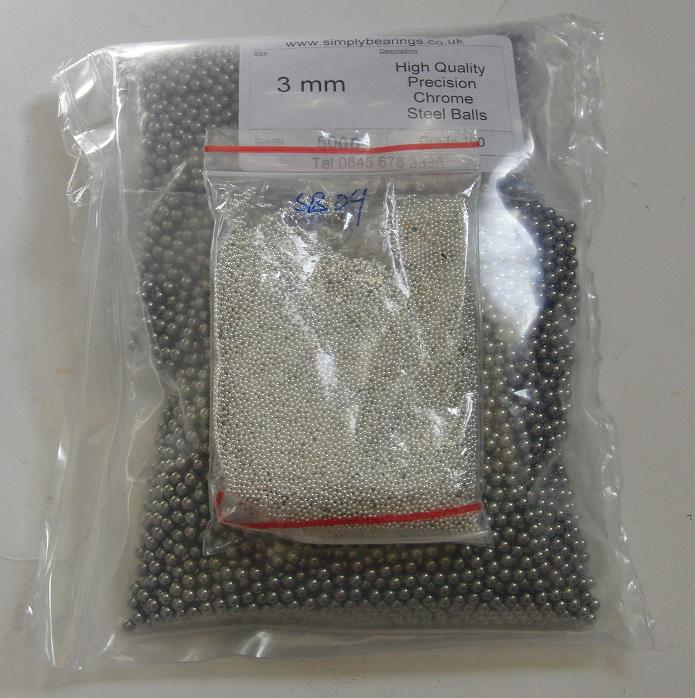

A small aside, to give an idea of scale this is what over 20,000 1mm BBs look like comapred to 10,000 3mm BBs:
