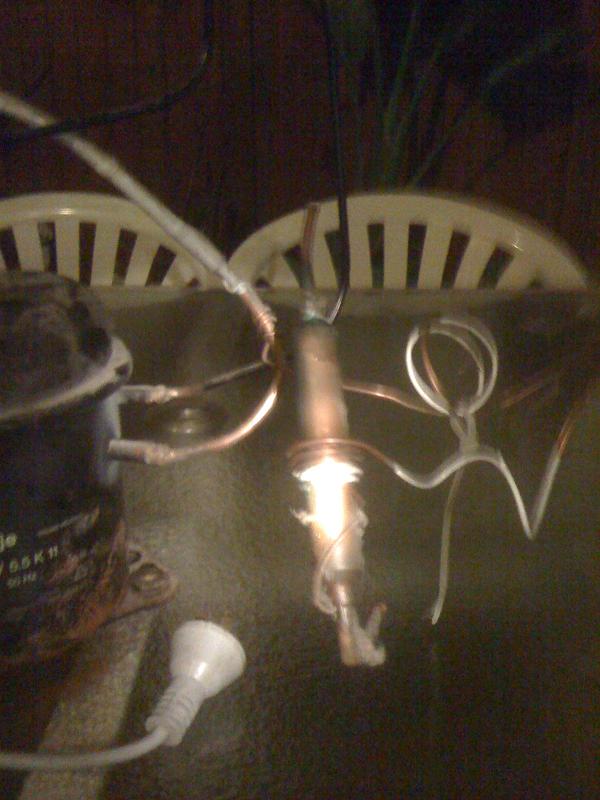

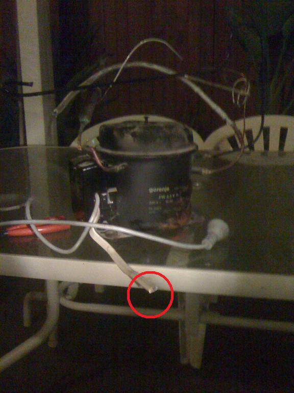

hey guys i got my fridge compressor i tryed to keep it to gether as possible there was only one electrical cable that i cut it lead into the fridge and i don't know what to do with it. if it helps it was made in yugoslavia and had r22 in it
there also is a wired copper thing i don't have a clue what it is
sorry for the bad pics its night and i only have a Iphone. ill put better pics tomorrow if you need them
we should make a thread all about fridge compressors every one can put there set ups in that thread and help others. theres been tones latey
thanks in advance
thanks in advance

[PUI]From what I know, the bottom cable is useless. Maybe connect a fan to it or something otherwise open up the plastic box and unwire it. Seems the grey cable is power, if you're unsure take off the plastic box and take a picture.
Have you tested it yet?[/PUI]
edit: argh just reads POLANDS reply!!

how many wires are there ??the cable in the red went into the fridge, it might have been from the light?. what should I do with it?
'lower' wires in MrCrowley's thread were also the ones leading into the fridge... there were 4 cables there ( hot, neutral, ground and one used to switch the compressor on/off then the temperature increased)... if there are 4 cables there you can wire it in the same way I suggested in that thread
AFAIK it's a valve... I know what it does but I don't remember what it's called... anyway, it's not neededthis is the weird copper thing

the cable in the red has 3 wires positive negative and earth and just remove them and use the wall switch ?
