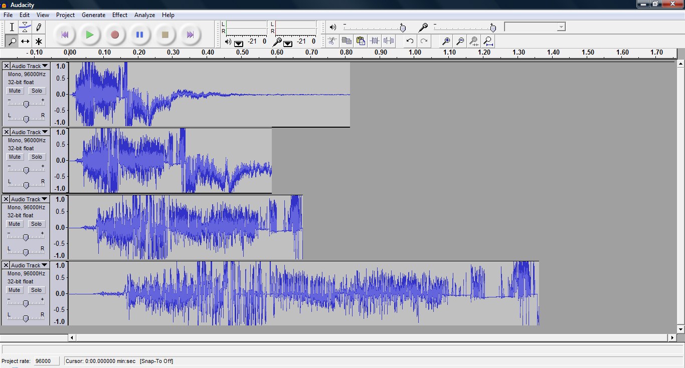

Tried some audio chronographing today, more difficult than I thought.
Parameters:
Cannon: V.A.L
Projectile: Golfball
Distance to target: 5m
Mic Distance: 2.5m from target and cannon
Target: MDF
Two of the audio files used an external mic, one used the laptop mic.
On shot 1 and shot 3 I got velocities of about 125m and 135m but that was sort of guesswork really. Wondering if anyone can help identify the impact points.
I also tried using SoftChrono but that gave me 220m/s, which is a bit out of GGDT's calculation. Think GGDT said about 160m/s for this cannon at 120PSI.
Attached in the .rar are the wav files and jpgs.

For the files to be of any use, the mic distance has to be known from the targets as it takes time for sound to travel from the sound source to the mic. If the distance is uneven (near muzzle and far from impact) then the sound travel time from the target back to the mike will need to be subtracted. Ideally a mixer board (stereo) and 2 microphones are used with each microphone set near each sound source at the same distance. That way the 2 mic to source distances cancel and the time difference is the flight time. A future plan of mine is to use a home built contact mic for the target mic. The plywood target would be the mic diaphragm.
When I'm not at work, I can do some evaluation of the sound files. I like to both listen to it, and look for the high frequency components of impact if they are not lost due to clipping or a speech input filter (common for voice use on laptops as a noise cancelling feature).
Shot 2 shows severe over compensation by the automatic volume control (sound mutes). If you have a way to attenuate the mic signal so the auto volume control is disabled, the sound would be much easier to evaluate. The flat portion in shot 3 shows this too. Do you have any recording equipment where the recording levels can be set manually with no auto gain control? The response from the sudden loud sound is causing problems with the recording.

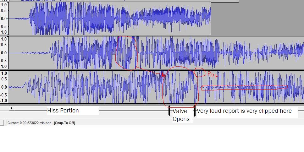

Edit, I was able to pick some stuff out of one of the shots, but due to the clipping, the impact info is lost. The hiss, the pressure wave of the valve opening and the pow of the projectile (crack) leaving the muzzle are identified. After that the sound sytem is hopelessly swamped.

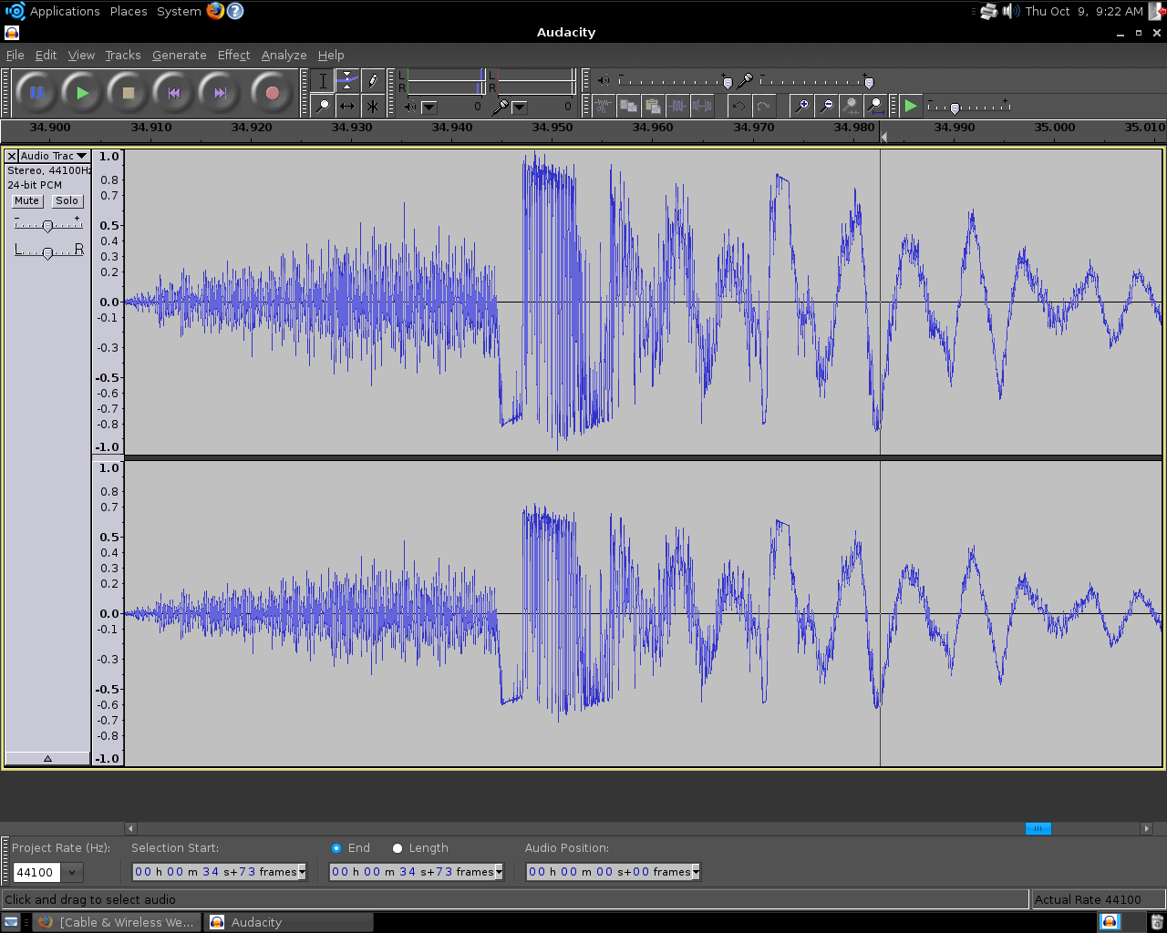

A good recording will look like this. The boom is still clipped, and could have been recorded at much lower volume, but the end of the hiss and the pressure wave of the boom is shown as a very sharp shift off the centerline. This is the Mouse Musket discharge indoors with no projectile. With a loud target impact after the boom, it would be easy to see in the trace.
- An unclipped proper recording will look like this. All the amplitude (volume) information is preserved. In this wave, it is easy to see when the main valve opened. Audio is the 3 gallon QDV. The pre trigger noise is mechanical rod movement. A pro Studio Dynamic mic was used to make the recording, not a condenser mic.
