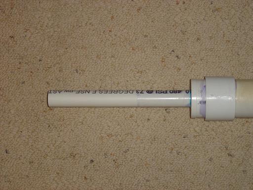

This is my first Barrel Sealing Coaxial Piston Cannon I have created and i think that I actually had more fun building it than I do firing it. It is very very powwerful for how small it is. The chamber is 2'' and the barrel is 3/4'' and the piston is made from a 1-1/4'' coupler. To relieve the pilot i have used a modded sprinkler valve. The pictures explain it all and any design suggestions or ideas would be greatly appreciated.

- A shot of the barrel and chamber alignment... I worked hard to get the barrel straight without alignment fins of any sort lol...

very nice gun but how old is the pvc? any damage pics?

i think the damage pics are gonna be of youspudkpi wrote:Haha the only older piece of PVC is the chamber only because I had it in my garage... no damage pics yet im gonna take some tomorrow... I can't find any good ammo for 3/4'' barrels? any ideas?

Nice cannon though. I like the fact that you used an O-ring on the piston. That gives it much more reliable equalization that you can control by choosing the size of the equalization port. Too bad I still haven't found anybody who can do O-ring grooves for me yet.

Yea I own a Jet Mini Lathe and I use a chuck on it that tightens around the coupler used for the piston and cuts ideal o-ring grooves. As for the PVC being old it is only about 3 months old so i put my full trust into it. It somehow became discolored. I used an O-ring on it because it slides better and i just created an equalization hole for air to fill the chamber. I do however need help with the seal. I am using a neoprene washer and it slowly leaks into the barrel???
