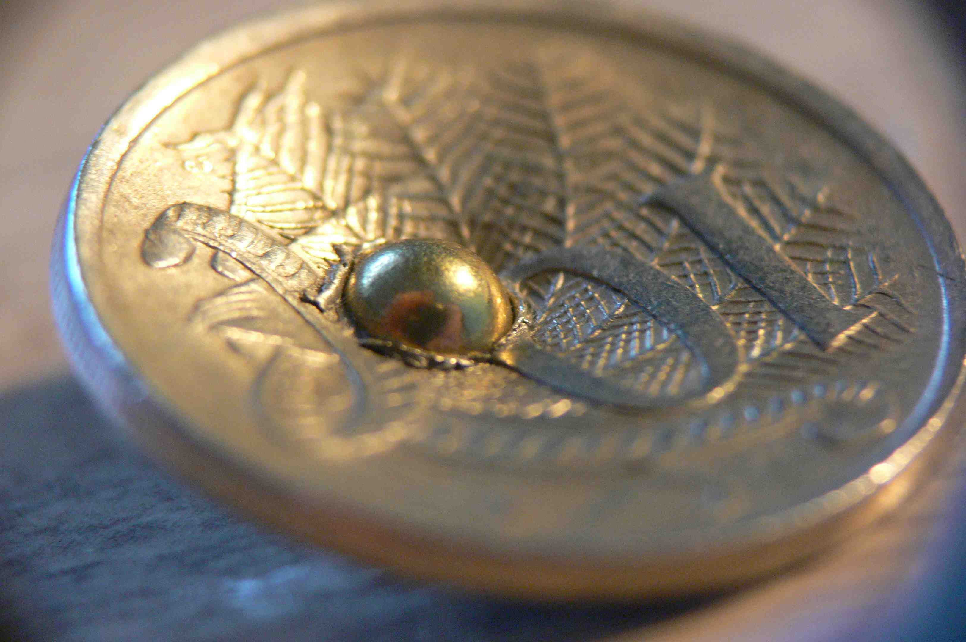

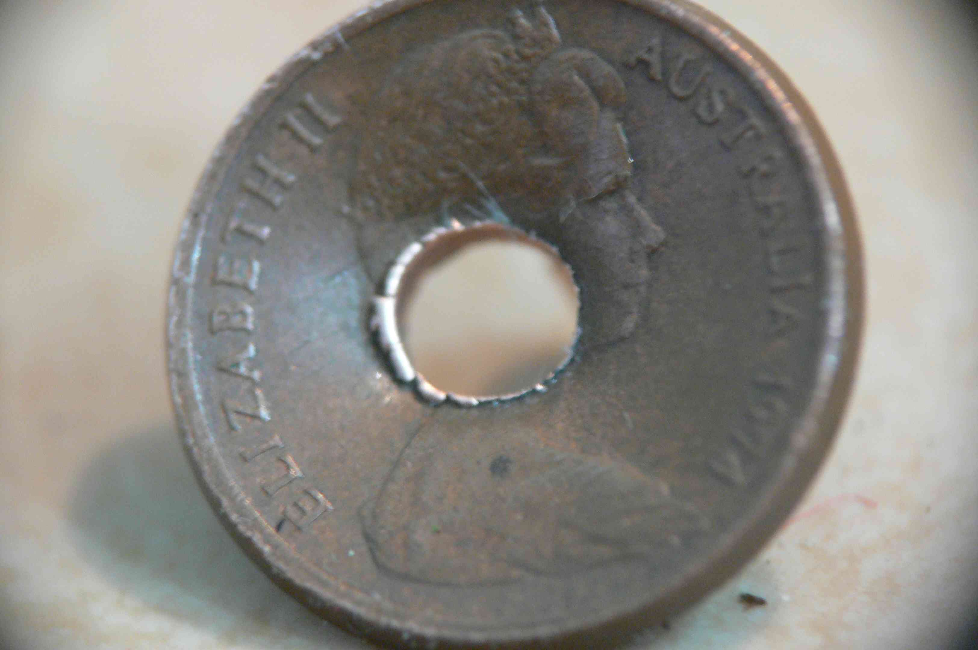

this shot was at 11x with a 4.5mm steel bb at point blank, hopefully i can get a vid soon

edit: got some more damage pics both were done at 15x with 4.5mm steel bbs
