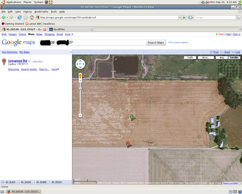

I took the time to post the GPS coordinates of each shot and take a screen cap, then with a photo editor I copied each marker onto one screen shot aligning the background of each edit for precise location. The composite photo is below.
The numbers are random spuds and apples from both the Marshmallow cannon and large cannon with the 2 inch barrel. The kids got turns shooting the marshmallow cannon at lower pressure. Not all shots were measured.
A whole apple was launched from the 3 inch barrel at 100 PSI to see if it would fly better uncut. It did and was the farthest shot of the day. No wadding was used and it was loose in the barrel.
A golf ball was launched from the 2 inch barrel with a paper towel at 50 PSI and one was launched from the marshmallow cannon at 100 PSI. That was the only two golf balls launched before we got rained out. I still need to find all distances in feet. I am checking my various GPS programs and settings to get this. So far, they convert to miles at 0.1 miles.
Click on the photos for a larger view.

Here is what I came up with using Google Earth.
- Technician1002
- Posts: 5189
I'll PM you the numbers right from the GPS. The launch site is the next big tree to the south near the gap between the trees.dewey-1 wrote:Here is what I came up with using Google Earth.
356 yards for golfball at 50PSI. (.20 mile)
424 yards for apple at 100PSI. (.24 mile)
