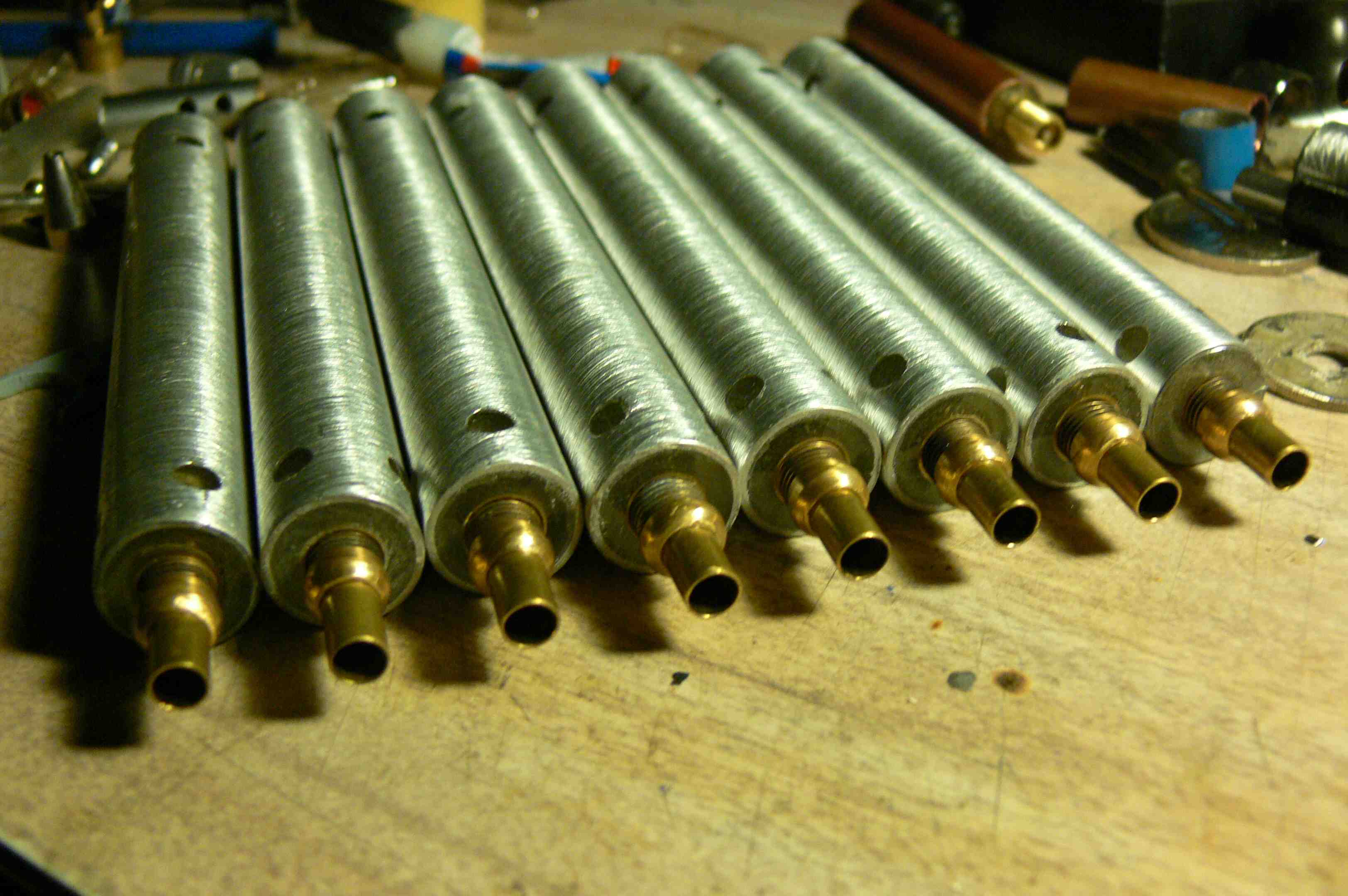

these are my hybrid cartridges that i finished yesterday, now i just need to start working on a gun that can use them, already got a bit of an idea how its going to work
volume: 12.75ml
length: 140mm
chamber: 14mm ID 1mm thick aluminum tube
bore: 5mm
fill valve: schrader
onion valve thing: modified schrader and schrader cap
if you want to know more feel free to ask questions
volume: 12.75ml
length: 140mm
bore: 5mm

I think you made a mistake on the chamber, is says 1mm
Waiting for pics, have you tested the power? What ammo? Etc.
oh right i can see how that would be confusing i meant to say that i was using 1mm thick aluminum tube, as for power it should be the same as my first mini hybrid that could shoot through a 5c coin with a steel bb at i think 15xGun Freak wrote:I think you made a mistake on the chamber, is says 1mm![]()

Those look amazing, Are the cartridges going to eject?
I love lamp
thanks, sadly no because there just aluminum they will get damaged to easily, also because im trying to get power i wanted the barrel to be a decent length but i dont want the whole gun to be really large so im just going for a simple single shot bolt action, but that is good enough for meLockednloaded wrote:Those look amazing, Are the cartridges going to eject?

Also, what did you use for a spark plug and what are the contacts?
I love lamp
have you seen JSRs hybrid cartridge thread? there is a small copper wire attached to the schrader that is less the 1mm from the chamber wall and that is my spark gapLockednloaded wrote:Also, what did you use for a spark plug and what are the contacts?

Excellent job, while I was wasting my time fiddling around with seals, there you were mass producing a proper cartridge
Shame it's going to be non-ejecting but I understand your reasons, looking forward to the finished launcher
yes well i do have a small problem though it seems that after a couple of shots the moisture built up seems to be stopping it from firing with those tiny spark gaps which is easily fixed with a blow gun but still very annoyingjackssmirkingrevenge wrote:Excellent job, while I was wasting my time fiddling around with seals, there you were mass producing a proper cartridge![]()
ve you experienced this?
Moisture? Could be residual gasses, what I usually do is before attaching the burst disk, connect the shock pump and pump for about 10 seconds to vent both the pump and the chamber.
yea i do that to, dont you ever get water build up in your shock pump? because once in a wile if i use the pressure relief valve it splatters water plus when i blow out the cartridges i can visibly see the moisture in the burst of air and when i stop seeing the moisture coming out it works fine, but i dont think that is the whole problem anyway i think iv made the spark gaps of a couple of the a little to small so ill have to test that and see if i can fix them.jackssmirkingrevenge wrote:Moisture? Could be residual gasses, what I usually do is before attaching the burst disk, connect the shock pump and pump for about 10 seconds to vent both the pump and the chamber.
and also you have the spark going to the schrader dont you? because i have mine going to the wall and that might be why i have a problem with the moisture (if thats what it is)
All my recent prototypes have had the spark gap at the schrader, as in the mini-hybrid:ilovefire wrote:you have the spark going to the schrader dont you? because i have mine going to the wall and that might be why i have a problem with the moisture (if thats what it is)
I can't say I've ever noticed any moisture though, either from the pump or in the cartridges themselves.
It was mainly for ease of construction, by making them like that I could be sure of the spark gap before I sealed the plug and poured the epoxy, it's a much more reliable method.ilovefire wrote:is there a reason you changed to that as your spark gap?
My current curing cartridge is similar to this for 3/8" bearings, I found a harder type of seal that should give me higher pop-off pressures, due for testing later in the afternoon
fair enough, might try it next time i make onejackssmirkingrevenge wrote:It was mainly for ease of construction, by making them like that I could be sure of the spark gap before I sealed the plug and poured the epoxy, it's a much more reliable method.
are you using a O-ring or a rubber tube, because i made one with a bit of rubber tube and the bb popped at about 200 psi and i had a bit of fun with it and after maybe 10 shots the burst pressure was less the 150psijackssmirkingrevenge wrote:My current curing cartridge is similar to this for 3/8" bearings, I found a harder type of seal that should give me higher pop-off pressures, due for testing later in the afternoon
