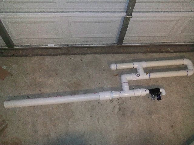

As discussed here, I have constructed my first piston valved gun. You can look there for pics of the inner workings of the gun.
Specs:
-interchangeable barrels, interchangeable chambers if I ever want to
-1.5" porting piston housed in a 2" tee
-no audible leaks past 20PSI
-1" sprinkler valve pilot valve
-stress ball bumper
-125PSI popoff and pressure gauge
I'm going to paint it soon, possibly over the weekend.
I love that I can pump the gun with just a bike pump.
I dry fired it twice (40PSI and 50PSI), and it was LOUD. I am quite looking forward to testing it out tomorrow. :D

Nice popgun.. Avoid heavy projectiles with that stock configuration so torque on the frame does not cause it to break.
mlz3000
Posts: 69
Joined: Sat Oct 23, 2010 4:55 pm
Sat Dec 04, 2010 12:00 am
I use the sprinkler valve as the stock(that's what the elbow joint on the back of it is for), and the chamber rests on my shoulder.
I might add a better stock to the list of to-do's for the gun, but do you think that kick might break it if I hold it as I have described?

That's an interesting configuration you have there. to reduce the chance of a recoil related catastrophic failure, you might look into a.....chamber support? :lol:
Maybe switch the elbow out for a tee and work a pipe up to help brace the chamber to the valve portion.

I like the chamber design. It's... different. I wouldn't worry too much about the torque issue, unless you feel the chamber being pushed into your collarbone or shoulder, it's minimal and probably not enough to cause serious damage. what would be a problem is if you were using the back of your chamber that actually looks like a stock as a stock.

Gaderelguitarist wrote:Maybe switch the elbow out for a tee and work a pipe up to help brace the chamber to the valve portion.
I might do that just to be safe, but continue to hold it with the chamber over my shoulder. It's just intuitively how I pick up the gun, seems easier to hold it like that.

Another choice is to build a new chamber, as the connection between the valve housing and chamber is threaded.
I'm thinking maybe a design like this one, but with a longer chamber that would run under the barrel.

Seeing as the connection to the piston valve is threaded, why not just... turn it around? Pictured below. This way you could add supports between the chamber and barrel.

mark.f wrote:why not just... turn it around?
If it kicks enough for me to be worried about needing a support, I'll do that, because that would make building a support really easy. Thanks for the great idea.
If it doesn't kick very much, (and all I'm firing out of here will be tennis balls and golf balls, so I don't know that the kick will be too bad) I'll probably leave it as is. I like holding it with the chamber over my shoulder, because that feels quite comfortable to me, plus I think big guns look coolest shoulder mounted. :D

@mlz, the kick won't be bad at all. I have a bigger valve on my golf ball cannon and the recoil is there but it is nothing to worry about. nobody bring up my awkward shoulder firings :roll: hehe
