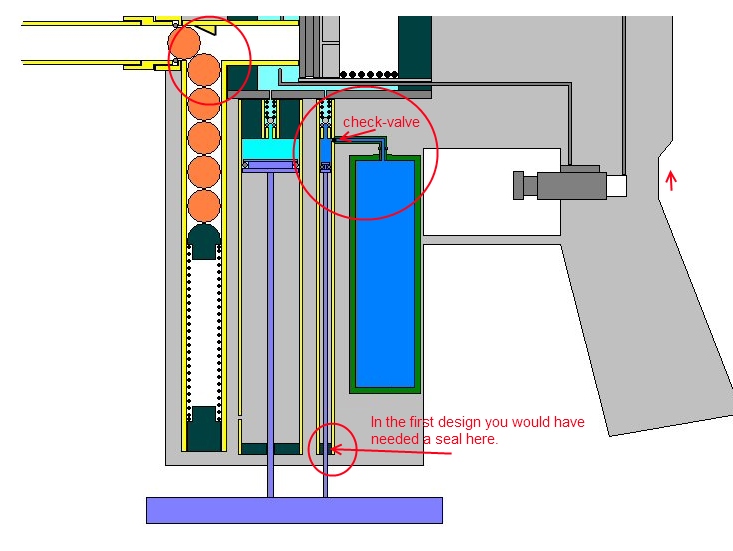

Looks tricky, but build-able, I like it, especially the double-pump-metering-system.
But I see two problems and one idea for improvement:
- Due to the fact, that one pump-piston will have a much larger surface, there will be a torsional moment at the point where the (larger-) pump-shaft meets the pump-handle. The whole construction would have to be very rigid...
-You would most probably have to add a little chute in the barrel, to avoid the balls from being pushed in the wrong direction (leading to multi-feeding...)
I would recommend furthermore, that you change the position of the fuel-line to the pump and add a check-valve , because otherwise you would have to seal the shaft of the smaller pump.
I added my thoughts to the diagram:
Edit: Don't ask me why there is a small red arrow on the right. I don't know.

Moar epoxyDue to the fact, that one pump-piston will have a much larger surface, there will be a torsional moment at the point where the (larger-) pump-shaft meets the pump-handle. The whole construction would have to be very rigid...
I didn't include it in the diagram but in practice a smaller diameter insert would be there to prevent backward feeding.
The problem with your solution is that the dual piston mixing relies on the fuel being at atmospheric pressure, but it's stored at higher pressure in the reservoir.I would recommend furthermore, that you change the position of the fuel-line to the pump and add a check-valve , because otherwise you would have to seal the shaft of the smaller pump.

right, but there is nothing to block the flow of fuel to the chamber...I would recommend furthermore, that you change the position of the fuel-line to the pump and add a check-valve , because otherwise you would have to seal the shaft of the smaller pump
though if you think of it you might as well get rid of the fuel pump
