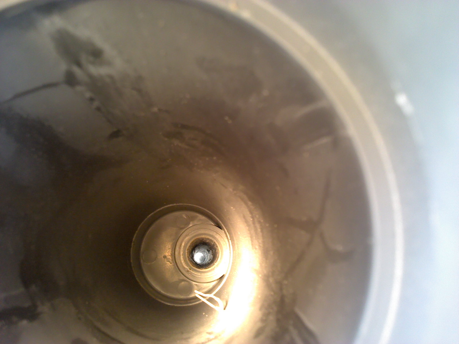

It looks fairly small in the picture, but it could just be the picture.

First things first, your endcap shouldn't fly off when firing. Are you using a threaded endcap? Because I don't see threads in that picture showing your spark gap.
As to the spark gap, I would recommend a distance of around 1/8" between the electrodes.

OK thanks you guys. I have tested with less fuel and the potato has launched about every first spark. It already goes really far with the cap flying off. I did however try duct taping it to see if that would hold it in place... For now it works, but I'm afraid it won't last long....
Here's a picture of the end cap part.

Yeah, that's pretty flimsy looking.
If you can't find a threaded cleanout cap, you may have to use the bottle cap idea your posted before. If you do, it would be a very good idea to install a chamber fan as well to aid in venting the chamber.
Another thing is, if you can find a smaller cleanout cap and spigot x FNPT adapter (female threads on one end and a small piece of "pipe" on the other), you could theoretically drill through the permanent endcap (before installing) with a hole saw the same size as the "pipe" on the adapter, push the adapter through, and then glue a slice of coupling on the other end of the cap.
None of this is the way the pipe and fittings were intended to be joined, though, so it would be much safer and better if you were to find a normal threaded cleanout cap and adapter.
