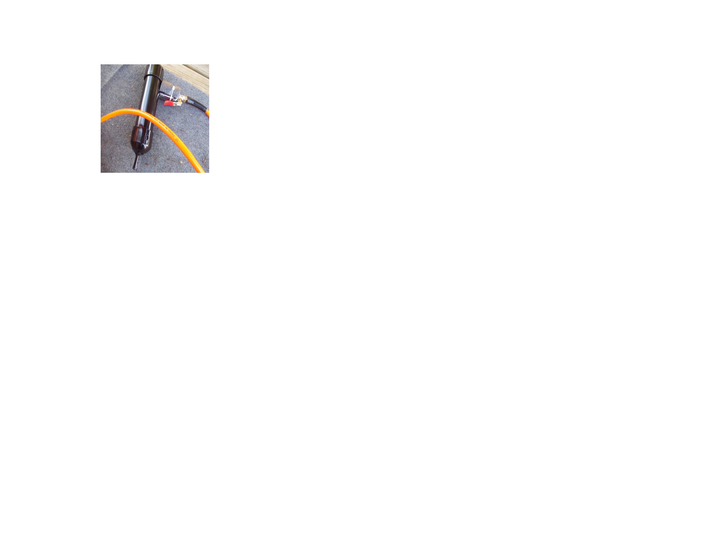

this is my homemade bbsmg it uses a 120 psi 5 gal tank and holds about 2,000 bbs. I still need to make a stock for it tho. 8)

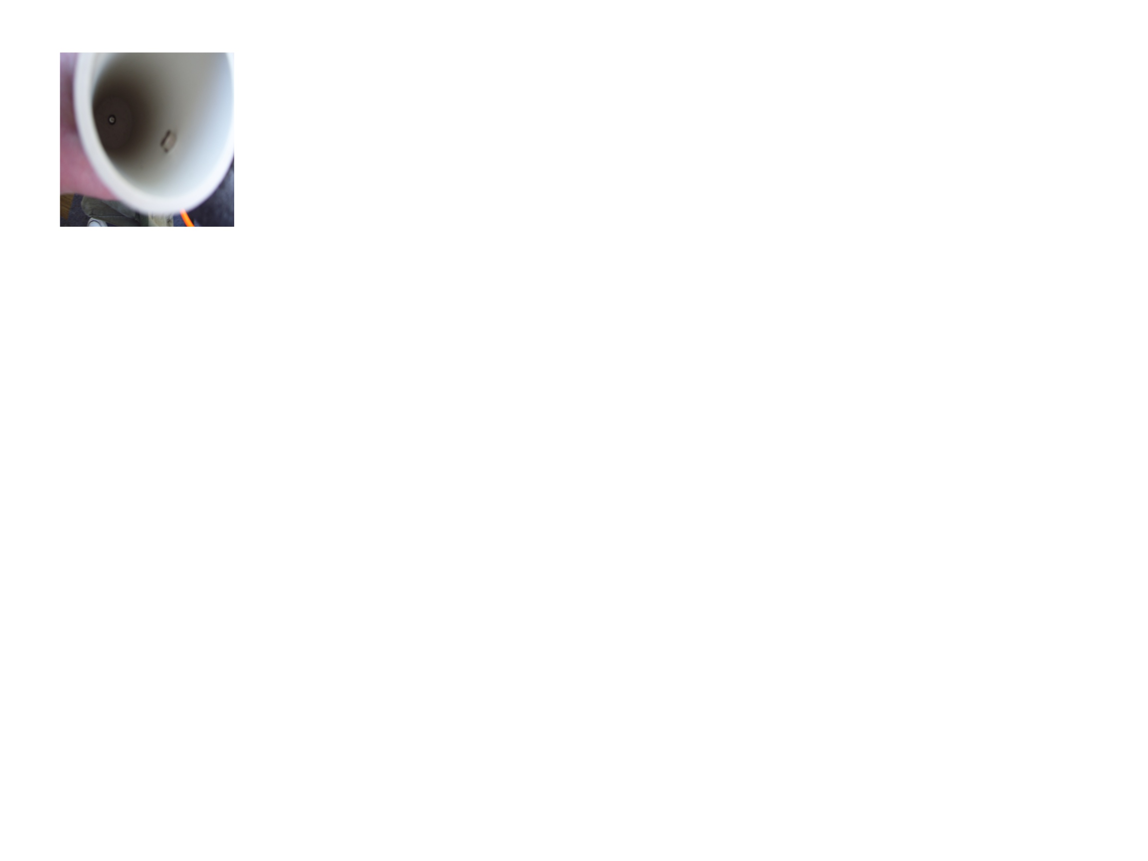

inside the chamber
inside the chamber

Looks good, but maybe some properly sized pictures would be nice. :wink:
How heavy is that air tank?
EDIT: and where did you get a 5 gallon tank? Smallest I've found is 7 gallon.

Nicely done but such a relatively large chamber can't be good for efficiency, have you thought of welcoming detents into your life?
A regged down paintball tank could probably give you the same firing time in a lot more compact package.
Why such a long hose?

i got the air tank at harbor freight tools its about 7 pounds and the hose is long because it was the shortest they had one in the store

When you make a stock, use the back end cap as a buttstock and use a trigger linkage to move the trigger and handle forward. That way, you can have a stock without making the gun longer!
