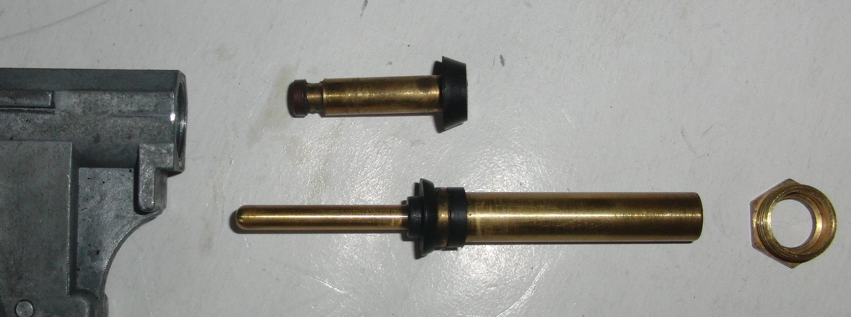

1)I Really need that thing infront of that light spring,is it a seperate peice from the metal part the spring lives on?or is it all one peice?( the bit thats a pipe cleaner on mine).
2) Need the light Spring itself.
3) the seal in the barrel that the bb sits in.
4)The two seals in the chamber at the back,where the Blowback Rod live's
5) the Seals out of the Mag if possible??
6) whatever is supose to hold the barrel down at the front,mine has a o-ring? but its too big ,could put a smaller one on but dont know what the original part was?.
If that part infront of the light spring is all one peice with the metal bit the spring sits on? I dont think it wil pass customs as it looks like a gun part. Cant tell on mine if its broken off or lost ( the pipe cleaner bit on mine)...
After more fiddling ,its getting more shots per fill but the slide still refuses to lock back after the last round? and still wont load bbs into the chamber and cant understand why it doesnt?.
if I fill the mag with gas and bbs,then rack the slide it will spit out 2 bbs at once,if I load it up and dont rack the slide then nothing comes out. The only thing I can think of is that front section with the light spring and Pipe cleaner= the pipe cleaner is probably not engaging with the nub on the inside of the slide and also the spring there is all out of shape and enlarged I tried to bend it back into roundness but its too missshapen.
