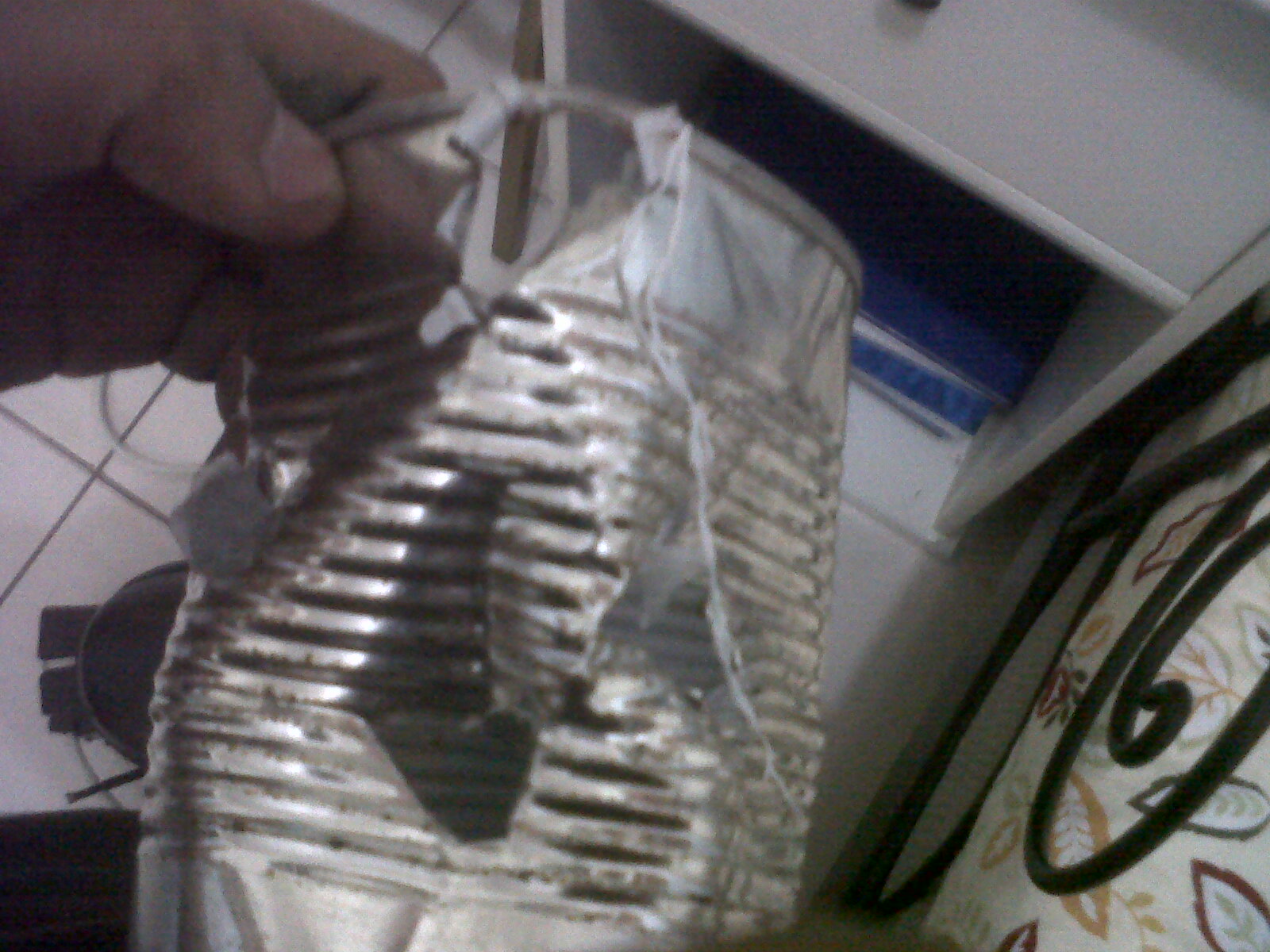

This is my first successful build of a pneumatic gun. Made it after several failed attempts. It is a high pressure air gun. I can fill it up to 600 psi with my fridge compressor but it takes almost 3-4 minutes so i usually do with 350 psi with my 600 psi pressure regulator. I have tried firing it at several objects. It totally destroys plastic objects with 7 gram bolts. I have even tested it on some stainless steel and food container of metal which it has both demolished. SO check out the pics and tell me wht u think....all comments are appreciated!

I like how the before and after destruction photos changed the type of can.   8)  Cool if you can take a screw top can and make it into a soup can in one shot.

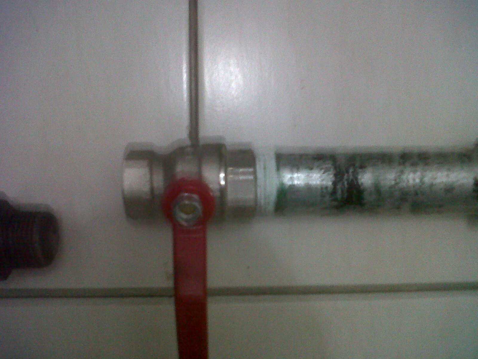

Unless the chamber is not in the photo, that chamber and valve are not 2 inch.
What size is the valve? Either that or you have some very large floor tiles.

Wow,those floor tiles are VERY SQUARE for 24''x12'', also, by size comparison to the xbox controller, you projectile, barrel, valve and chamber are 1''
a 2'' brass ball valve would be impossible, even if lubed, to open in 0.5 seconds by hand....Please post a photo of the Xbox controller next to the valve.... it will help clear up the confusion.
ALSO: that first can you posted... is a PVC primer can. something most of us on spudfiles know better than our own reflection.... and that IS very thin aluminum.
(The title of your image of the valve, says 1''... making your chamber also, 1'')
The soup can was shot more than once....hole going in both directions....
why?
why?

Ok since every1 is so confused ill post up a video explaining everything and comparing all the sizes and the damage shots will be included!!!!! Hope that will clear the doubts!!!!
For Now Here Is A Size Comparison:
http://s1194.photobucket.com/albums/aa3 ... -00032.jpg
And ur right tht is a pvc primer/glue can frm ace hardware(thin but not as thin as pepsi cans)!
Cheers[/img]
Cheers[/img]

I too noted the 1 inch valve.
Can you kindly provide a photo of the complete launcher with the 1 inch valve and 2 inch chamber all in one shot? Without it I tend to believe the launcher is vaporware. The only complete real launcher we have seen so far has a 1 inch chamber with a 1 inch valve. It is in the photo labeled

The primer can is the undamaged can. What can is the damaged can?
						Then the photo showed the valve and chamber are the same size. Nice try on the most recent photo. A quick change from Galvanized water pipe to Black Iron pipe without a reducer or valve is noted.My 1 Inch Ball Valve As Trigger
I have personally found soup cans to be thinner than primer cans, though not as thin as Pepsi cans. I can open Pepsi cans by hitting one with a marshmallow. I have video showing it. Opening a soup can with a bolt is not that impressive.And ur right tht is a pvc primer/glue can frm ace hardware(thin but not as thin as pepsi cans)!
Based on new data, GGDT predicts that the launcher has a muzzle velocity of 158fps:
Please note that the opening time is in milliseconds, 1,000ms is one second. You said you could open the valve in less than half a second, so I guessed .4s or 400ms.
