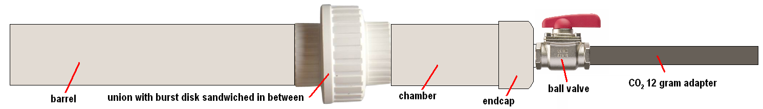

Wow, again most helpful replies folks
Thanks esspecially for the design suggestion - nice naming of the .png file also
I think I will build just that. Is it drawn in the right dimensions/relations?
Furthermore, apart from the valve really no steel is needed?
When using the burst disk the negative properties of the ball valve become irrelevant, right?

it's not really drawn to scale, you can make the barrel longer. The only steel needed is the parts that hold the co2 besides the burst disk part.Iceblade wrote:Is it drawn in the right dimensions/relations?
CorrectWhen using the burst disk the negative properties of the ball valve become irrelevant, right?
Sometimes words just pop into my head.Iceblade wrote:nice naming of the .png file also
No - because you have to download GGDT and work it out for yourself!I think I will build just that. Is it drawn in the right dimensions/relations?
(subtle hint
Assuming a disk burst pressure lower than the PVC ratingFurthermore, apart from the valve really no steel is needed?
Completely.When using the burst disk the negative properties of the ball valve become irrelevant, right?
