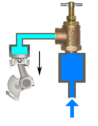

Gunfreak, unless you're using high pressure, I would suggest a much larger piston head.
A pressure relief valve could be used to drive the piston...

How would the air supply cut off on when the piston is on the upstroke?
- POLAND_SPUD
- Posts: 5402
the piston exposes the vents -> pressure drops -> pop-off valve closes
I don't like that design - too many variables that have to be tweaked

How about this, the pop-off piston is the actual piston. The piston is loose in the cylinder in order to stop it hanging.POLAND_SPUD wrote:I don't like that design - too many variables that have to be tweaked
- popoffengine2.PNG (6.99 KiB) Viewed 2242 times
