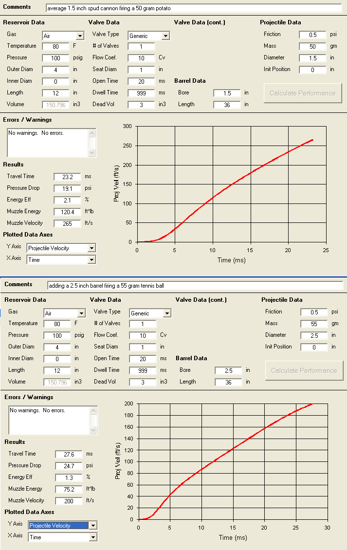

Naturally the flow restriction will limit performance, but on the other hand there's more area for the air to push on.
Short of actually making it, GGDT is your best bet to have a good idea of what performance might be like.

Impossible to calculate without knowing all the data for your launcher, as well as any real world performance data with the 1.5" barrel I'm assuming it has currently fitted.
Here's some educated guesswork, as you can see you lose quite a bit of power with a tennis ball because it's got such a poor density, but for firing heavier projectiles (like a full soda can which should fit exactly in a tennis ball barrel) muzzle energy goes up considerably.

Roughly the data I worked with so the above results stand as a rough guide.
jsefcik wrote:i can put soda cans really far!!!!
GGDT says around 400 feet, but it doesn't know that they'll be tumbling end over end...
