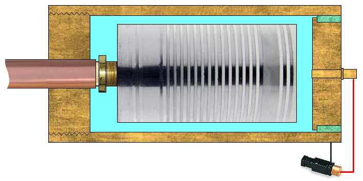

Here's a concept, using a screw capped tin or maybe a PET bottle, full of light gas attached to a barrel with a burst disk in between, all housed inside a hybrid chamber...

Interesting concept, but it seems pretty flawed. There will be a lot of energy wasted deforming the inner chamber, and the inner chamber won't fully crumple, effectively creating a lot of dead space. Plus, there's a lot of surface area to cool the combustion gasses, which can't be good. Admittedly, the inner chamber, if heated, would still transfer that heat energy into the projectile's acceleration, so I'm not sure if this would be detrimental to the performance.
I think this is a design that really does require silly amounts of special chemicals to be practical.
In the case of a hybrid driven launcher, a piston is probably a better idea.Insomniac wrote:Interesting concept, but it seems pretty flawed. There will be a lot of energy wasted deforming the inner chamber, and the inner chamber won't fully crumple, effectively creating a lot of dead space.
That's what I was thinking, hot pressurised helium... which could also be pre-pressurised to compensate for the dead space.Plus, there's a lot of surface area to cool the combustion gasses, which can't be good. Admittedly, the inner chamber, if heated, would still transfer that heat energy into the projectile's acceleration, so I'm not sure if this would be detrimental to the performance.
As I said, no intention of building it, but an interesting option to put out there.I think this is a design that really does require silly amounts of special chemicals to be practical.
