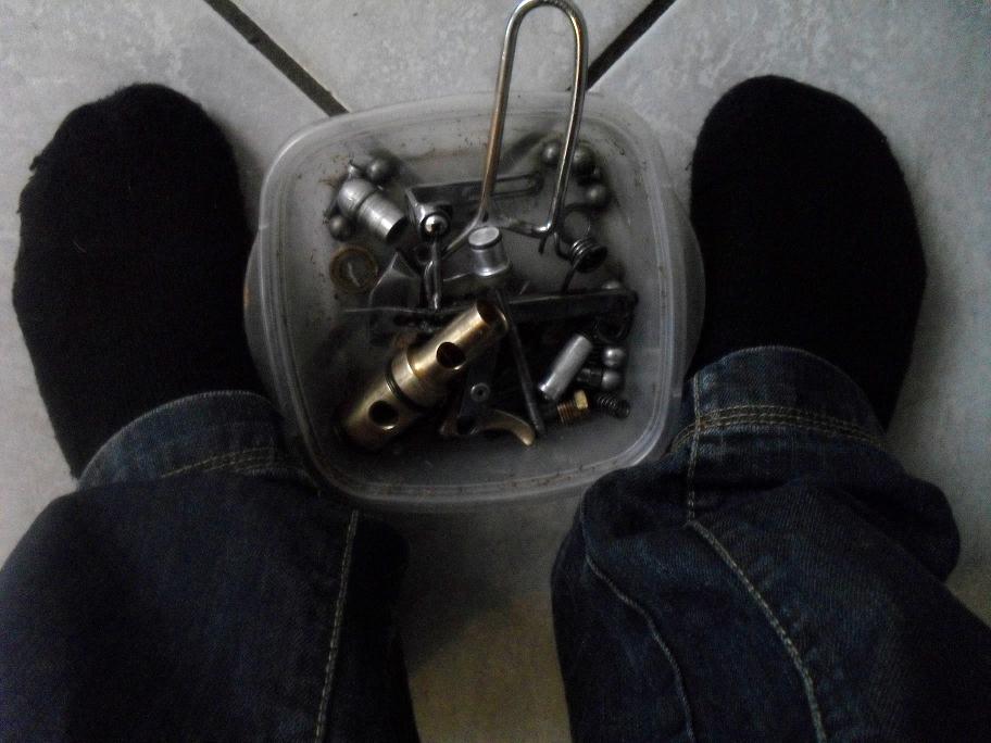

Update!
After the valve's O-ring had failed ( cheap @$$ quality btw) I had to take the entire gun apart.
But.....I put it back together and more...
The bottom picture was made for a certain somebody... :D
Reduced to a pile of junk...<br /><br /><br />Now how did my feet get in there?!??!
Sat Oct 22, 2011 5:22 pm
Sometimes I wonder if my campaign against feet in photos was misguided. I really hadn't thought it through :roll:
Regardless, coming on nicely :)
